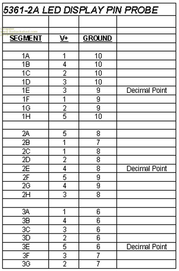

Here is what I have found so far:

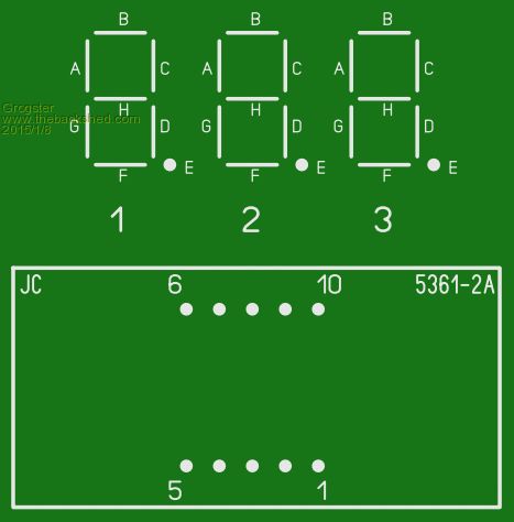

Display graphic:
Pin probing chart:
From what I can gather, is is therefore a common-cathode display, but interestingly, there seems to be five distinct groups of common connections instead of the more usual three(one for each digit).
Can anyone here make more sense of this chart then me at this point?
EDIT: I am now going to draw this chart as a schematic to see how things are set up behind the epoxy.
EDIT: Last line is missing from the chart. Segment 3H: V+=4, GND=7.Edited by Grogster 2015-01-09

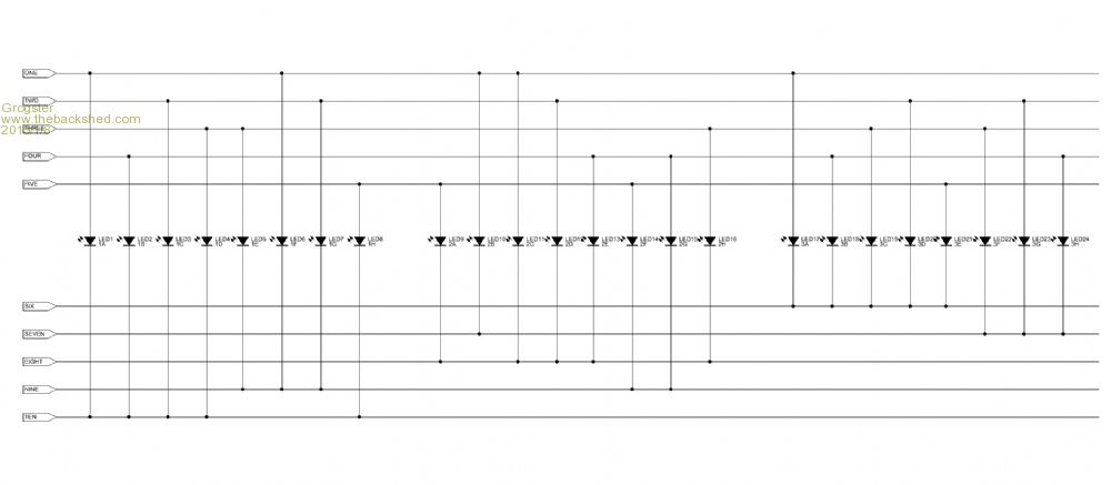

Here is the schematic, drawn from my probing chart:
Me thinks this is a matrix LED display rather then a common-cathode.
The same thing as a keypad matrix, but just a little little larger.
No wonder I got them for about 50c each at the time!
Still, now that I know how it is wired up, I could easily dedicate a $3 MicroMite chip to act as an I2C or serial driver....
EDIT: Image is a little fuzzy, so here is a link to the GIF file which will show it clearly.Edited by Grogster 2015-01-09

looks like there are 24 segments, arranged in a 5x5 grid. the only combination not used is 5-7.
working out how to drive it will be fun, but not too difficult. hint: for each digit (0-9) in each location (1-3) you'll need to store 25-bits, which will all nicely fit in a table of 30 integers on a mk2 micromite.
