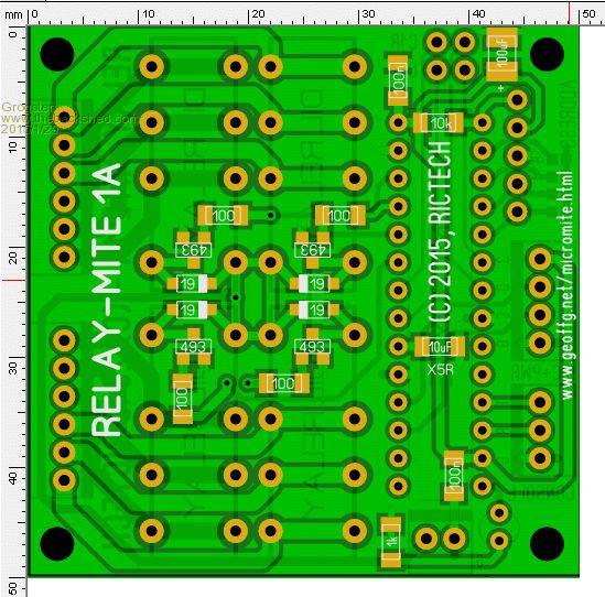

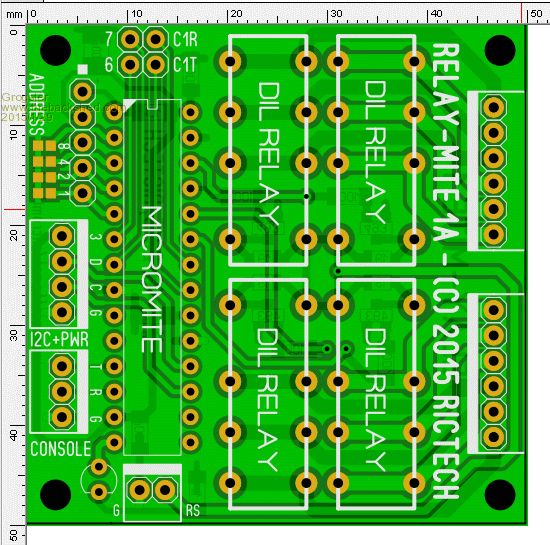

Hi folks.
This board is 50x50, and has the full-size DIL micromite chip + four DIL relays on-board.
TOP COPPER:
BOTTOM COPPER:
The board is designed to be connected to the I2C bus, and you can select the slave address between 0 and 15 with the four solder-blob pads. The relay supply is seperate from the MM supply, so you can use relays with different coil voltages(but they all must be the same). Full back-EMF clipping and transistor driving of the relays. COM1 is brought out to a 2x2 pin-header, along with I/O pins 6 and 7, so you can also make local use of the MM serial port, and a couple of I/O pins.
If you were to daisy-chain 16 of these boards together, you would have access to 64 sets of relay contacts, all via the I2C bus, with just the two I2C lines. You could use as many as you needed, and you could also leave off relays from the board if you needed less then four.
I have yet to write the MM code(that's next), but this is the board.
The code will allow for momentary, latched and timed relay modes for each relay, and every relay(up to the maximum of 64) will all be addressable indivitually over the I2C bus.

No design by committee? :) (I would have suggested a GND for the com port connection)
I see that pin 6 is also on the header for the serial port. That would make using RS-485 a possibility.
What are the limits for voltage and current of those relays?

I'm still tweaking the PCB design, so time for a little design by committee!!!
I will squeeze a GND in there for the COM port - good thinking. (it begins!!!!!!!!)
EDIT: Oh, forgot the relay specs you asked about. Any standard DPDT relay in the DIL footprint should fit(normally referred to as HK19F's ). These can be had in several different coil voltages on eBay for about US$2 each. I am using relays with a 5v coil, but you could use 12v or 24v ones if you wanted - up to you.
The contacts of my 5v ones are rated for 2A per pole @ 30v DC or 1A @ 125v AC.
I have all four relays contacts wired in parallel pairs, so each DPDT relay becomes SPDT, with the rating of 4A @ 30v DC.
THIS BOARD IS NOT DESIGNED OR INTENDED TO SWITCH MAINS VOLTAGE!
I am guessing that most members here would realise that, but I should point that out now, to avoid any confusion.Edited by Grogster 2015-01-30

I mentioned pin 6 for RS-485 but i should have said pin 7 as that is the COM1 EN pin.
Great, that ground pin will allow an easy single cable/connector.

  TZAdvantage said  I would not put those contacts in parallel though. They are not guaranteed to switch simultaneously risking a higher current going through a single contact.
Especially at the moment of switching a load ON there is normally a peak current (motors), and that would make that situation worse.
Maybe i am overly cautious. :)
I was originally going to have all six connections for each relay, out to pins, but I did not have the space. There is no reason why I could not use a double-row pin header and get ALL the connections out to pins, so that each relay would then be true DPDT, but this would mean the PCB tracks will HAVE to be much smaller to get them all in, which will affect the current handling ability. This may, in reality, prove to not be that much of a concern. Even 1mm tracks should be able to handle 500mA no problem, and 1A as a maximum I would think. It also depends on the copper weight(thichness of laminate), and you can add solder coating to the thin tracks(making them thicker) so they can handle more current - there is always a way!
I was(and still am) in the middle as to which way to do that aspect of the relays myself, so I would love some kind of responses from other members here:
Q: Do you think that all the relay contacts should be available and not set as SPDT as now?
Answer just needs to be YES or NO, and I will count the responses. Whichever one wins(even if there are only a few responses), will be how I configure the PCB.
