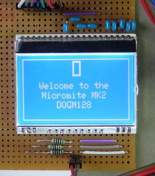

I received a request for a port of the graphics routines for the DOGM128 LCD display which uses the ST7565R controller.
So here it is
Pinout for CD (marked A0 on datasheet), CS, and RESET can be set in Basic. Pinout for the SPICLK and SPIOUT are of course fixed.
The Cfunctions are identical to the OLED and NOKIA SPI displays.
2015-01-31_113625_DOGM128-SPI.zip
