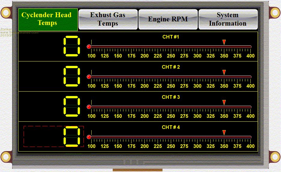

So, maybe order the DuinoMite-Mini Board from Olimex to use as the prototype and then get this going... I want to use this as a protocol converter to listen to the Rs-485 buss to receive data for the objects on the 4-D Systems 7" touch display used for my EIS system I am developing... The Duinomite also has the SDcard interface on it to store the "CSV" based log files being stored to keep track of the engine data collected during the flight of an ultralight aircraft... Logged data will consist of CHT, EGT temps, RPM, battery voltage and the like... Still working on the different parts of the system... This part will be one possible "display device" the pilot might choose to install...
There are other types of displays we are designing, one involves using a MM to drive very small servo's to create "old-school" style instruments if wanted... My friend ED (the guy with the 3-D printer) is creating the gauge casings and face plates for them... All displays will listen to the Rs-485 buss to get there data... The "front-end" module will be collecting the engine parameters and send out the Rs-485 data packets... I am thinking to using the LTC2983 from Linear Tech to get the temp data from the thermo probes... this is an awesome IC that uses the SPI port to transmit data and commands... This project is bigger that I first thought... Edited by Zonker 2015-03-02

Was hoping for at least 115200 baud... The Display can go up to 600000..!! No need to go that high.! But, I just don't want the pass through data to build up and start causing problems... Receiving the Rs-485 packets, processing, limit checking, serial protocol conversion and sending the serial data to the display all takes time... Not to mention the writing of sample data to the log file on the SD-card in CSV format...
I won't know what the "final" loading will be on the Maximite until more of the code comes together... there are almost 20 different data objects to feed on the user display including the RTC.. Just trying to think ahead...Edited by Zonker 2015-03-02
