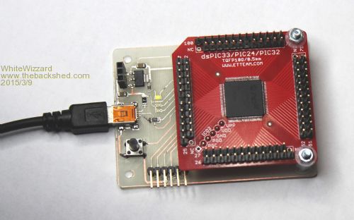

Please see below a photo showing the carrier board I was talking about (slightly customised to make a bit better than the ones I use daily). Note that this is a homemade PCB on 0.8mm board; I can get more made (possibly at a fab house) if anyone shows an interest!
The carrier board is effectively a simple interface between a popular TQFP-100 Break-Out-PCB and a computer's USB port. The BreakOutBoard plugs into the Carrier Board and is held in place with a couple of screws to give the thin 0.8mm carrier a bit more 'rigidity'.
All of the MX470's MMBasic Pins are available as male header pins and can be connected to simply by using female ended leads (and off to a BreadBoard for example). This allows you to very easily 'play' with the 100pin MX470.
Under the BoB is the onboard FTDI (GENUINE!!) chip and a couple of support components.
To the left (starting at top) is a 3-way female header providing 5v (from USB), 3v3 (from onboard LM1117 800mA reg), and 0V (nearest USB socket). The 5v supply is polyfuse protected (500mA).
Below the standard miniB USB socket is a reset switch (I find these so invaluable when testing).
To the right of the USB socket are three LEDs. The top one (green - honest) is a 3v3 power indicator. This indicates that the MX470 is getting 3v3 and effectively comes on whenever a 'powered' USB lead is connected.
Next is a Red (usb) Tx LED that flashes whenever the MX470 receives some data i.e. a keypress on TeraTerm.
The third LED is a Green Rx (usb) LED that flashes whenever the MX470 sends data to TeraTerm.
Below the LEDs is a 6-way ICSP connector. Pin 1 is on the left - when a PicKit3 is plugged in then the PicKit3's front panel will be face upwards for ease of use.
Total current consumption of the two boards is around 42mA (with all I/O pins not driving any loads).
The beauty of this set-up is that it is great for testing, and then if you actually design a circuit, the BoB can be unplugged from the carrier and run independently.
This is a slight modification to what I have been using since MatherP introduced the MX470. It has proved extremely useful and has only been modified to hopefully meet Panky's needs.
Thanks to Panky for ordering one of these! Your unit is loaded with MMBasic100 v4.6b+B10 (the latest I have from Peter).
Feedback, criticism & suggestions are welcomed . . . .

@WW
  Quote  To the left (starting at top) is a 3-way female header providing 5v (from USB), 3v3 (from onboard LM1117 800mA reg), and 0V (nearest USB socket). The 5v supply is polyfuse protected (500mA).
PYI Phil,
The pinout of the 3 way female is 0V, 3.3V and 5V (with the 5V closest to the USB connector) - the reverse of your statement above, No damage but it caught me out for a bit.
Cheers,
Doug.
Posted: 10:33pm 28 Mar 2015
@panky
I obviously suffered a 'blonde' moment there - sorry . I can even see the USB connections so clearly in the posted photo so not sure how I slipped up. Anyway, its good to throw in the odd challenge now and again
At least the PTC was there!
Let me know how you get on with it . . . .
