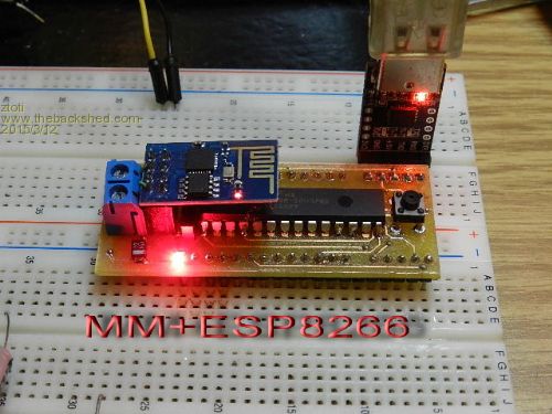

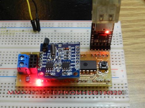

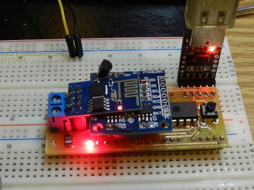

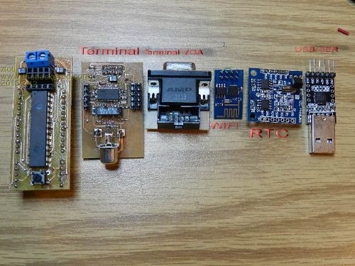

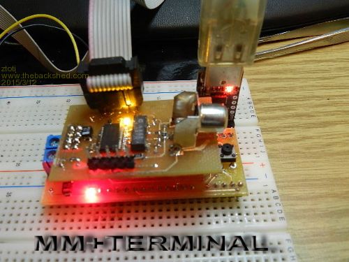

Hello,
I've designed for my purpose Micromite with I2C connectors compatible with RTC modul from eBay: http://www.ebay.com/itm/I2C-RTC-DS1307-AT24C32-Real-Time-Clock-Module-for-Arduino-Uno-AVR-ARM-PIC-FO-/291326542429?pt=LH _DefaultDomain_2&hash=item43d46a425d
serial connector compatible with ESP8266 module:
http://www.ebay.com/itm/ESP8266-Serial-WIFI-Wireless-TransceiveR-Module-Send-Receive-LWIP-AP-STA-T-/261757554829?pt=LH_D efaultDomain_0&hash=item3cf1f7508d
Serial connector compatible with:
http://www.ebay.com/itm/400565980256?_trksid=p2057872.m2749.l2649&ssPageName=STRK%3AMEBIDX%3AIT

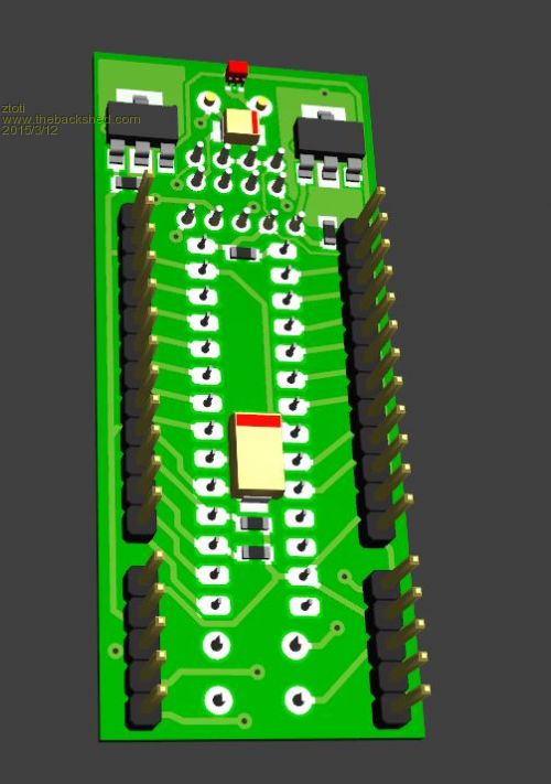

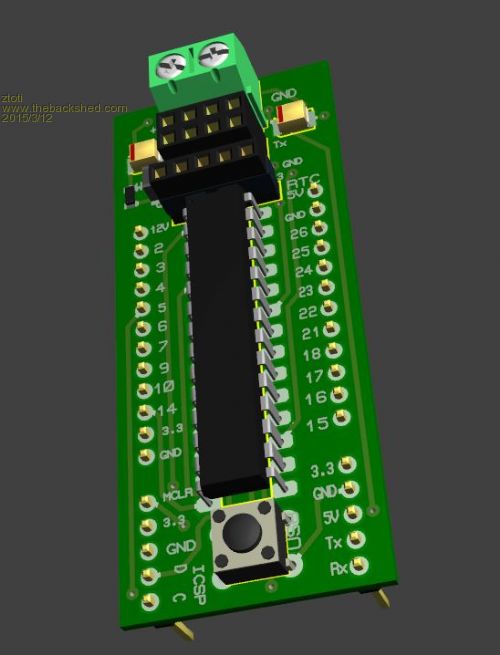

and I made terminal compatible with serial connector like ESP8266 so there is PDF file with SCH, PCB, 3D PCB
https://dl.dropboxusercontent.com/u/42611861/Micromite28.pdf
and images.
This is my Micromite fellowship :)

Very good Ztoti,
I particularly like the VGA on the PCB with 10pin header, These take up a lot of room on a normal PCB and your board makes mounting easy and a short 10 pin header cable to mate with your main PCB.. I like that.
My only suggestion might be to add the RCA for composite to it and mount EITHER the VGA or R/A RCA socket..
