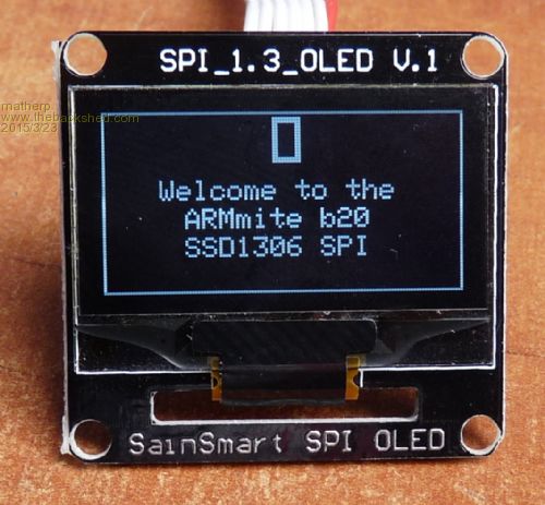

I'm not intending to embed drivers for the various monochrome displays into Basic. These work in a different way to the colour displays and require a screen image to be maintained in memory in order to calculate the updates required.
However, the original Cfunction display driving code, when compiled in CoIDE and converted with CFuncGen4ARM works perfectly on the ARMmite.
Example files are attached for both I2C and SPI OLEDs. Remember to set the offset parameter in the call to the OLED.init routine to 2 for 1.3" displays and 0 for 0.96" displays.
2015-03-23_103912_OLED_ARM.zip Edited by matherp 2015-03-24
