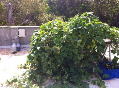

This is the system, the cistern is behind with a 12v dc pump circulating water up. The box at the back is where the automation is meant to go.
