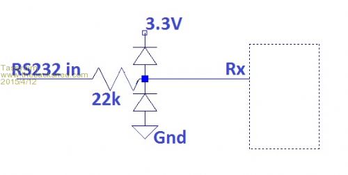

I can't seem to receive correct RS232 serial data, just garbage. I put a 22KOhm resister and clamping diode on the TX line as per MM Manual (pg. 70). Putting a scope on the line, it brings the levels down to +5.2V ~ -5.8V. The orginal levels are +6.4V ~ -6.2V. I thought following the MM manual would bring the levels closer to 3.3V.

If you are referring to a ColorMax 2 like your signature suggests then it seems that the serial ports top out at 19200. However, I couldn't find a manual that matched with serial info on page 70. The other thought was that if the serial pins in use (which pins?) are specified for 3.3 volts then they are probably running far too high at 5.2 volts.
What product are you using and what manual are you referring to?

Sorry, I just got a mkii (44pin, 4.6b version) last night from Micromite.org (highly highly recommend their business) and started to play around with it. I'll update my Sig when I'm back at my desk.
Page 70 from the latest mkii manual shows how to bring rs232 down to TTL logic. I'm not sure if it should be clamping right to 3.3volts, or if the 5volt signal is safe enough.
*EDIT: I was using the scope while the TX line wasn't connected (in fear of blowing the chip with circuit). When I connect the line up, the scope reads +4.5V ~ -1V.
Using com1 (pins 8 & 9 on MKii 44pin), which hardware supports the baud. I have a max 232 chip that I may end up using but hoping the mkii can handle it. I know I'm not handling the serial content correctly right now, I'm just trying to get valid data first.Edited by MolsonB 2015-04-12

It seems to be a signalling problem. The hardware hack (for want of another word) may not support 57600, the example in the manual is at 4800 baud.
Can you test it at a slower baud rate?
What does the waveform look like on the CRO? Square or sloping edges?

If you suspect a bit rate problem and it does look like that, then you can check the bit rate on your oscilloscope. At 57600 speed a bit should be a little over 17 microseconds long. You should see enough single bits in any data stream for easy measurement. If you find a significant variation in the length of the bits then divide that bit length in microseconds into 1,000,000 to get your baud. Sync on the leading edge of a start bit and expand your time base to have one character across the screen. If you have storage then is easy.
edit:
Given you are running at 5 volts then you may have to specify the OC switch on your serial open command and use a pull up resistor to 5 volts on the PIC transmit pin. However, that won't directly affect what you are receiving at the PIC.Edited by BobD 2015-04-12

If you want to reduce the voltage levels to be closer to 0-3.3V, I would use Schottky diodes as they have a much lower forward voltage drop (and faster acting). I also like to have one going to ground to limit the negative voltage swing.
With the extra diode and using Schottky or other low forward voltage drop diodes the swing should be -0.2 to +3.5V

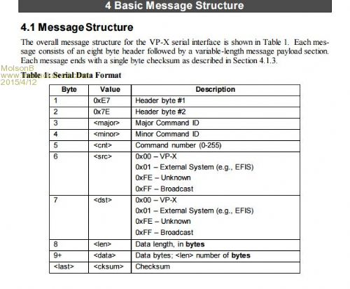

Good old ASC function to the rescue. The data wasn't ASCII, you nailed it. I've been playing with bluetooth data for to long, where things are nice and friendly to send.
Here's a snip-it right from their PDF file.
My looping output now displays the ascii values.

I could use your guys help. How do I go about processing the data, comparing, reading, etc. Do I leave it in string format, convert to ascii, hex?
INPUT$ brings in the value as a string.
ASC converts that string to ACSII code so I can actually read it.
The program sends all their values as HEX 0xE7, 0x7E, etc..
When I'm looking for the header key values, do I check for E7, or convert to ascii and check 231 ?
I'm getting tangled up in the basics of serial communication.

As the data is not ASCII, you would probably be best leaving it as a string.
This means you can't visually print the "Characters" as they are not ASCII, but you can still use your storage string idea to hold the data as it comes in.
It would be helpful if the sending module tacked some kind of end-of-message marker to the message such as CR or LF or both. Do you know if your module does that?
IE: Header bytes, then payload bytes, then CR or LF or both as end-of-message marker bytes.

The module does not send an end-of-message marker, just the first 2 hardcoded header bytes. I'm ok with that, I check if there is a complete header (9 bytes and more) and the hardcoded header markers at the start, to process the message.
The last byte is a checksum, and this is what I have.

I tried a different approach that is tailored just to this transmission. Within all the data coming fast at me @ 57600 baud that I can't seem to process fast enough, I'm really only interested in 2 messages. They get sent every 1Hz (1 second). I only want the latest message, don't care about the message a few seconds ago still in the buffer Q.
I know this isn't the right way to handle the serial stream, but within the com interrupt I process the data.
1. Flag a new message when the 2 header bytes are detected
2. Check the next 2 bytes which tells what kind of message is coming in (I filter out the ones I don't want to see so they don't get processed)
3. Append to a string.
4. The lengths of the messages vary, have to read the payload length byte first
5. Once the full length is in, save to a specific variable and start again. This way the latest and greatest message gets stored in their own variable.

That was the other idea in my head, to read more bytes instead of 1 by 1. Since it's likely the message will be split into the next buffer message, I'll have to store part1 and read part2. I'm taking Wed off, so I'll get to play around with this during the day.
Thanks for another way to look at it.
