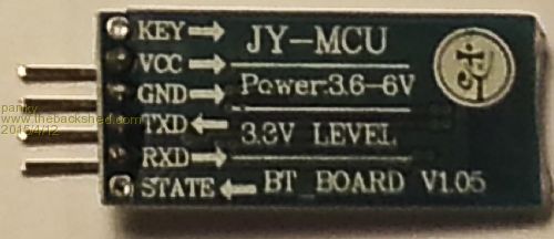

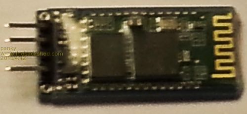

Have spent several days playing (fighting ) with a JY-MCU serial to bluetooth module so I can send data from a Colour Maximite to an Android tablet.
The module, shown below, is a JY-MCU unit. It has a bluetooth device name of linvor, connects at 9600, 8, N,1

Sorry, thought of a couple more things-
you need to pair the JY-MCU with the Android tablet first - it will show up on the tablet after a scan as linvor
Prior to the connection in the Android program, the red led on the JY-MCU will be flashing - once connected, the red led will go on solid.
