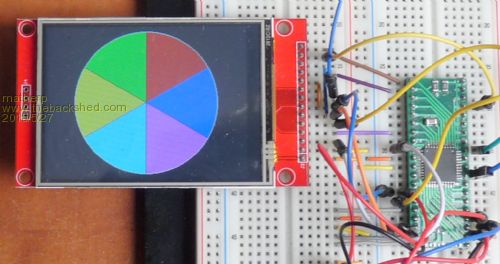

First, many thanks to Geoff for the huge amount of work he has put into the MM2. I'm always amazed at the times (in the UK) at which I receive emails. Geoff is hugely responsive to ideas and with the new facilities in 4.7b8 there is now little or nothing you can't do with a Micromite given a bit of effort.
Given the limitations of space on the PIC32MX170, it was not possible for Geoff to include triangle drawing but with the new Cfunction capabilities in 4.7b8 it was trivial to convert drawing code to work as a Cfunction using the MM2's internal routines. This means that the user interface to the Cfunction is much simpler than my old routines. The code below will run on either the 28 or 44-pin chip and any of the three supported displays without any changes (don't forget the ILI9163, it works perfectly). Note that the code doesn't need to know about the pins in use or the display type as this is all taken care of by the MM2 firmware.
I've tried to keep the calling sequence to the triangle routine as similar as possible to the internal routines so :
funcreturn=triangle(x1,y1,x2,y2,x3,y3,outlinecolour,fillcolour)
The only real difference is that the fill colour is a mandatory parameter and should be set to -1 if an outline shape is required.
Triangles seem like a fairly useless drawing function but they are actually the basis of all computer 3D-graphics and they allow you to do things like the above. The code for this is :

Just tried the above Peter and it's amazingly fast considering what it has to do. Mine ran at 492mS using 2.8" screen, MX170 and V4.7beta8.

Got the same 492ms on the 4.2" touch panel... (nice)...
