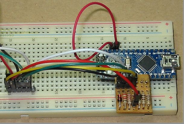

Posted: 12:08am 03 Sep 2015
A pic of my Nano PIC32 programmer and patented veroboard addition :) The 5 programming pins are available on the top headers, while the bottom header plugs into the breadboard.
Turns out the Nano PIC32 programmer is more than twice as fast as a PICkit2 using pic32prog!

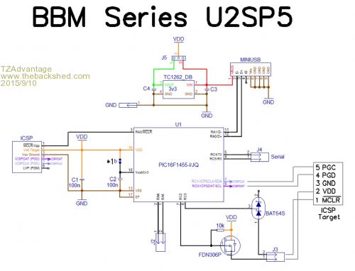

Posted: 05:05am 10 Sep 2015
@Rob,
I have looked at the schematic for the nano and it looks pretty simple.
Also the code that runs on the nano is well documented.
I would like to investigate the possibility to extend the capabilities of my current USB-Serial 'block' to be able to act as a programmer instead of the nano.
Reading the source it is stated that pins D2, D3 and D4 are used as Open Collector outputs.
In the datasheet (page 4 point 1.1.6) of the 328 however it looks like those pins are not open collector capable but are of the push-pull kind.
Is this an error in the documentation? Or am i overlooking something and the pins can be set into a open collector mode.
I suspect that the pins are used in a normal output mode but only when the output is a logic '0'. When a logic '1' is needed then the pin goes to input mode and is high impedance. To simulate a Open Collector output. Would that be the case?
To make the hardware more safe i could add a schottky diode.
A mosfet to enable/disable power to the target would also be possible to add to the circuit if i can find one that is small enough. :) The user can determine if it is 5v or 3.3v with a jumper.
EDIT: I changed my schematics with what would be needed to be able to use it as a programmer. What do you think?
Edited by TZAdvantage 2015-09-11
Posted: 02:06pm 10 Sep 2015
TZadvantage: you are indeed correct, the 'open collector' effect is achieved by switching the pins between output and input mode. in every sense this is quite real, as the high-side transistor is always off, while the low-side one is toggled.
the crude method of delivering power to the target (3x 100r resistors and a 3v3 zener) was used in the interests of simplicity. a mosfet is a tidier solution, but i didn't use one because of cost and complexity. i had also considered a 3-terminal regulator, but a zener was cheaper and the 50mA standing current draw was inconsequential. i spread the load across 3 output pins with balancing resistors to keep below 20mA/pin.
do be aware that the (master) source repository at:
https://github.com/sergev/pic32prog
is lagging behind my one:
https://github.com/robert-rozee/pic32prog
the main difference being that serge's version is still running the serial connection at 500k baud, while mine has it throttled back to 115k2 along with extensions to handle 4-bit/symbol encoding. i am just waiting for serge to update his (master) branch.
since you are using a single device for both USB bridge and programmer, the serial speed difference probably doesn't matter, but the 4-bit extensions will. however, they are backwards compatible.
you may need to add a configuration jumper to your design to select the 'ascii ICSP' mode. this jumper could be inline with the pin 7 output - you could then sense the presence of the current 10k pullup to Vdd as indicating the need to enter 'ascii ICSP' mode instead of 'serial bridge' mode.
i do like your idea, and fully support it
rob :-)

  robert.rozee said   since you are using a single device for both USB bridge and programmer, the serial speed difference probably doesn't matter, but the 4-bit extensions will. however, they are backwards compatible.
Actually I think it will matter.
In my initial tests with the 16f1455 I was starting to get communications errors on speeds above 115200 Baud.
It may be possible to get higher by adding a xtal but if your code is set to 115200 and we know that the 16F1455 is reaching the limit above that rate, I would say they are a good match.
Chris
