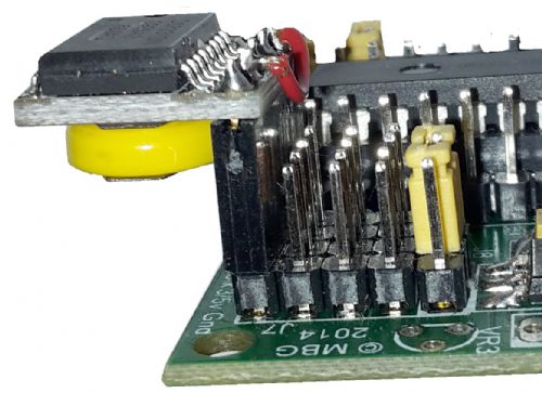

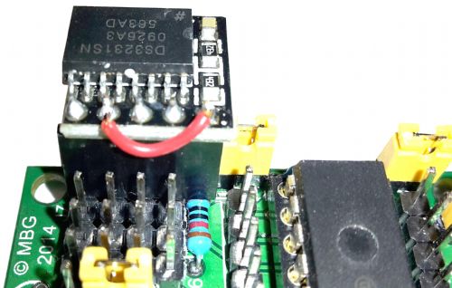

All that is needed to plug into my `Mik-Standard' I2C bus is to run a short wire (red in the following pictures) from Pin 1 to Pin 4 of the 5 pin female header and offset the module when you plug it into the I2C 4pin header so that pin 1 is hanging over as shown below.

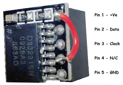

The Pinout of the Module is as follows:
As can be seen pin 4 has no connection and this mates up with `Mik-Standard' for I2C power (set to 3v3) and every other pin lines up... The short link transfers the power to where the module expects it to be on pin 1.
I have had it running now for about 2 weeks and (after synchronizing my PC to internet time) it had lost about 2seconds in 2 weeks.
Not a bad $2 investment and of course can be adapted to any other I2C pinout.

Is that a 1992 week 6 chip?
Or does it mean something else?
Posts: 2981
Posted: 09:46pm 28 Aug 2015
@Greg,
Yes I did think that .. Which is what prompted me to first post this thread.
@TZ,
I would have to look at the datasheet but my guess would be not that old.
Posts: 6550
Posted: 10:23pm 28 Aug 2015
My interpretation of the date code is week 26 of '09

Posted: 10:47pm 28 Aug 2015
Yes week 26 of year '09 makes more sense.

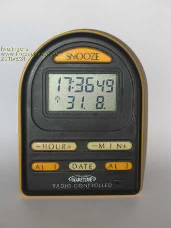

Just for information purposes (regarding accuracy):
I use a 1$ DS3231 module from china and compared with a radio controlled clock is there a difference of one second after four month.

I don't know. It is a very old clock (I have more than ten). I guess I've bought the clock 20-30 years ago. Maybe from "Conrad Electronics" (a german company).
Do you think there could be any influence on the DS3231 module?
(The older the radio controlled clock the better the accuracy of the DS3231?)
