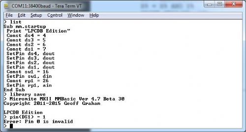

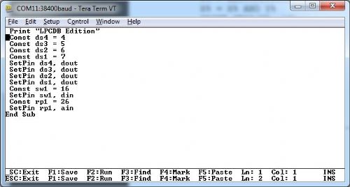

not sure if it is me or if there is a bug in the EDITOR:
if I edit I get this as soon as I press any key:
I did try re-flashing with Beta 30 just in case I had corrupted anything but the problem persists with or without a library loaded and on any program I try to edit.
The second issue is if I run it:
Cheers,
Chris
Edited by Chris Roper 2015-09-18
http://caroper.blogspot.com/
Posted: 12:31am 17 Sep 2015
Chris,
If you reboot and then type
? ds1
Does it show 7 or 0?
Also - should be pin(ds1)=1 i.e. normal brackets!
WW

  WhiteWizzard said   Chris,
? ds1
[code]
> XMODEM RECEIVE
Saved 226 bytes
> library save
> Micromite MKII MMBasic Ver 4.7 Beta 30
Copyright 2011-2015 Geoff Graham
LPCDB Edition
> ? ds1
0
[/code]
[quote]
WW[/quote]
They are normal brackets, just the low res screen capture makes them look weird
Basically the code runs as the message appears on reset but the constants are being cleared before the prompt loads.
If I include pin(ds1) = 1 inside the mm.startup then the LED lights.
Chris
Posted: 01:04am 17 Sep 2015
@Chris,
I get the same as you if CONSTs declared in MM.Startup i.e. they equal zero at command prompt after a re-boot.
This must be a bug surely??
I am trying to get constants declared (for pin names) so that in Command prompt at any time, or in a user program, I can refer to the pin by a name rather than a number.
If I don't use CONST (but just say ds=7) then I can get a solution apart from at the command prompt AFTER the editor is trigger. Hence my post above asking if other LIBRARY Subs could be created to trigger when Command prompt entered, or editor entered.
WW
EDIT: Could be the sequence of things as I also mention in an earlier post - would be better if MM.Startup runs AFTER the firmware has done it's stuff (i.e. just before the command prompt appears)Edited by WhiteWizzard 2015-09-18
Posts: 12040
Posted: 01:08am 17 Sep 2015
  Quote  I get the same as you if CONSTs declared in MM.Startup i.e. they equal zero at command prompt after a re-boot.
AFAIK this has always been the case, nothing to do with libraries or the new code, just the way Geoff designed it to work.
CONST declared in a subroutine or function only have scope inside that function. For this reason when developing the early display drivers things that I wanted as constants but I also wanted to define in an initialisation subroutine had to be defined as DIM and not CONST
Edited by matherp 2015-09-18
