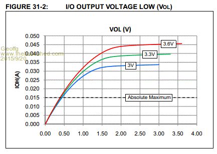

When you are sinking or sourcing a significant current there is also the voltage drop across the internal PIC32 driver to consider. This graph comes from the MX170 data sheet.
I don't know why they extended the graph above the "Absolute Maximum". Perhaps to prove how tough it is.

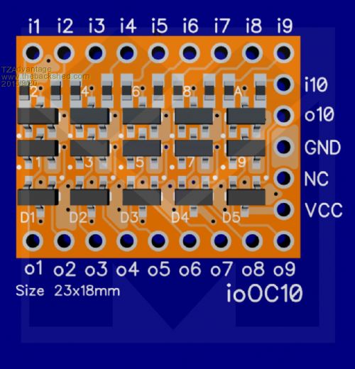

I actually designed a pcb for that purpose, alas it is not in production yet as i have to take it through some rigorous testing.
Here is the schematic, it might help you get on with your project.
The transistors are NPN Switching. The diodes are only needed when using it for switching relais or motors.
2015-09-20_054318_ioOC10.pdf
This will be the PCB (23x18mm)
Edited by TZAdvantage 2015-09-21

Great info! Thanks. I will have to use a driver of some sort for sure.
TZ, that is a nice little board. The bat54c is a nice part for this. Just out of curiosity, why did you go for 10 outputs instead of 8? Also how do your "Blocks" get put together, it looks very interesting.
Posted: 05:29am 20 Sep 2015
I am actually considering a BAV70L diode as the bat54c is hard to get where i live. They are functionally the same and also the same package.
I put ten on the board because that is how many i could cram in there.
My first choice was to make one with 4, then i changed my mind and made one with 8. Having pins and PCB room left i though well why not 10.
I also recently ran into a requirement that needed 10. See micromite keyboard thread where i use a 4017 to provided 10 outputs for the rows of a matrix. These are not OC so having a small board like this comes in handy. Then you have things like servos, stepper motors, etc that can require many OC outputs. (Think robots, xyz platforms for 3d printers/cnc etc).
Having a single version of a small pcb is also more cost effective. 'Competitors' already offer 4 or 8 versions so need to differentiate.
That being said. I am still considering a smaller pcb with 4 of them. Just to have the smallest pcb available and you not have more outputs that you really need.
The Microblocks should only deliver what is needed. Finding the right balance is difficult and at this moment i try to make 'blocks' that have a single function and are as small as possible.
