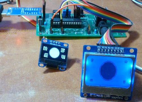

As promised here is the last of the CFunction tutorials. This time the objective is to write a loadable display driver. Many months ago, the first displays I looked at were the monochrome SSD1306 OLED displays and the Nokia 5110 LCD displays.
These have been somewhat superseded by the huge choice of colour TFT displays but they still offer an option where the requirement is a small but visible and cheap display technology that can be connected using SPI. This tutorial will develop a fully worked loadable driver for the SSD1306 OLED display.
The Micromite firmware from V4.7 provides hooks to allow loadable drivers to be written for displays in C that can then be accessed by the standard Basic drawing commands: TEXT, BOX, CIRCLE etc.
There are three routines that need to be written as part of a CFunction display driver:
First, there must be a "main" program that initialises the display and hooks the drawing routines into the Micromite firmware.
Second, there needs to be a drawing routine to draw a filled rectangular box on the display.
Finally, there needs to be a drawing routine to write a two colour bitmap to the display.
It is that simple
Everything else is created in the Micromite firmware using just the two drawing routines. So a single pixel is a rectangle with length and height both set to 1.

So given the above we can look at how to implement a driver for the SSD1306.
Colour displays use multiple bits of information to describe the colour of each pixel. However, in general monochrome displays use one bit per pixel and so typically a transfer of one byte of information to the display will update 8 pixels. This means if I want to change a single pixel I need to know the current value of the 7 other pixels which are linked in the same byte of input. I could do this by reading the display memory but in many cases of SPI displays they do not provide read capability so this is impossible. This means I need to keep a memory map of the current state of the display in my microprocessor memory.
In the case of the SSD1306 display it is 128 pixels wide and 64 pixels high so I need to maintain a memory map of 1024 bytes (128*64/8) to track the current state of the display.
The SSD1306 (in common with many monochrome display drivers) organises the display as 128*8 bytes so byte zero relates to pixels 0,0 0,1 0,2 0,3 0,4 0,5 0,6 0,7 i.e. a line 8-pixels long running down the screen starting at the top left hand corner (0,0).
It supports a mechanism for positioning the writing point (0-127,0-7) to define which set of 8 pixels will be updated.
To get the SSD1306 to display anything at all it needs some configuration data written to it. All display controllers need initialisation and they are all different. Google and the controller datasheet are your friend in sorting out the requirements for a specific controller. In the case of the SSD1306 it is quite straightforward particularly compared to some of the colour display controllers.
So to summarise this introduction:
We need to write three routines for the SSD1306: initialisation, drawrectangle, drawbitmap.
We need to handle the hardware mechanics of talking to the display (SPI)
We need to create and maintain some persistent memory to use as a memory map of the display.
In the next post we will look at the initialisation code. If you followed the previous tutorial most of the techniques used will be familiar.

Next we need to tell the Micromite firmware about the size of the display
if(Option->DISPLAY_ORIENTATION&1){
HRes=HorizontalRes;
VRes=VerticalRes;
} else {
VRes=HorizontalRes;
HRes=VerticalRes;
HRes and VRes are defined in cfunctions.h
Finally we need to set the locations of our drawrectangle, drawbitmap, and updatedisplay routines for access by Basic, clear the screen and restore the SPI configuration. We return the address of the memory map to Basic so that we can inspect it if required using PEEK.
//Set the DrawRectangle vector to point to our function
DrawRectangleVector=DrawRectangleVectorOffset;
//Set the DrawBitmap vector to point to our function
DrawBitmapVector=DrawBitmapVectorOffset;
//Set the end of Basic statement vector to point to our routine
CFuncmInt=updatedisplayVectorOffset;
//CLS
DrawRectangle(0,0,HRes-1,VRes-1,0);
SPIBRG=brgsave; //restore user (or my) setup
SPICON=consave;
SPICON2=con2save;
return (unsigned int)p;
That is all we need in the main routine. Next post I'll look at the actual drawing routines. I'll put the complete code at the end of the thread.
