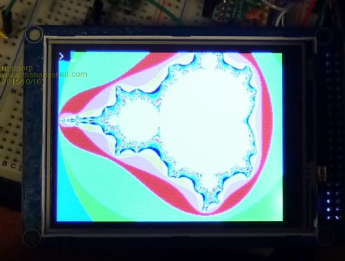

The SSD1289 controller based TFT displays are very cheap with 240x320 resolution and have a proper touch controller and SD card slot (e.g. )
By modifying them as specified here they work well in RGB666 mode with an 8 bit databus.
This driver allows them to be used on a 64-pin MM+. It won't work on a 100-pin as the pin allocations for RS and WR are different in the way Geoff has set up the 100-pin.
For the 64-pin MM+ use the standard pins as defined in the "Advanced Features" Manual for the SSD1963. All MM+ commands including GUI and full touch will work as normal.
Using the display as a console nearly works - I need to discuss with Geoff why the text doesn't scroll and if this is fixable but for normal output it works superbly and updates very quickly.

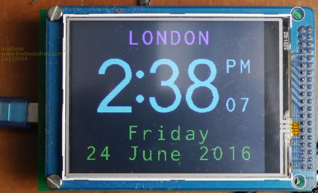

Updated version of the SSD1289 driver that implements improved error checking on text which overlaps the screen real-estate
Seen here being used to run Geoff's Super Clock software on a 44-pin MM backpack PCB
44-pin version - see comments section for pin usage
