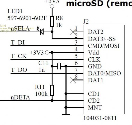

You can solve this in the hardware. Just add a LED which will be on when the /SEL line is low

This is the simplest possible solution. I have used it many times

Hm... that is interesting. Did you measure the voltage on the CS pin?
Have you tried to leave the resistor, but short the LED only and see what will happen? Then we can think a bit more... This is strange because I have used this method before and it worked just fine. But we must find the cause in your case.

Yes, with MM+... what is your LED?

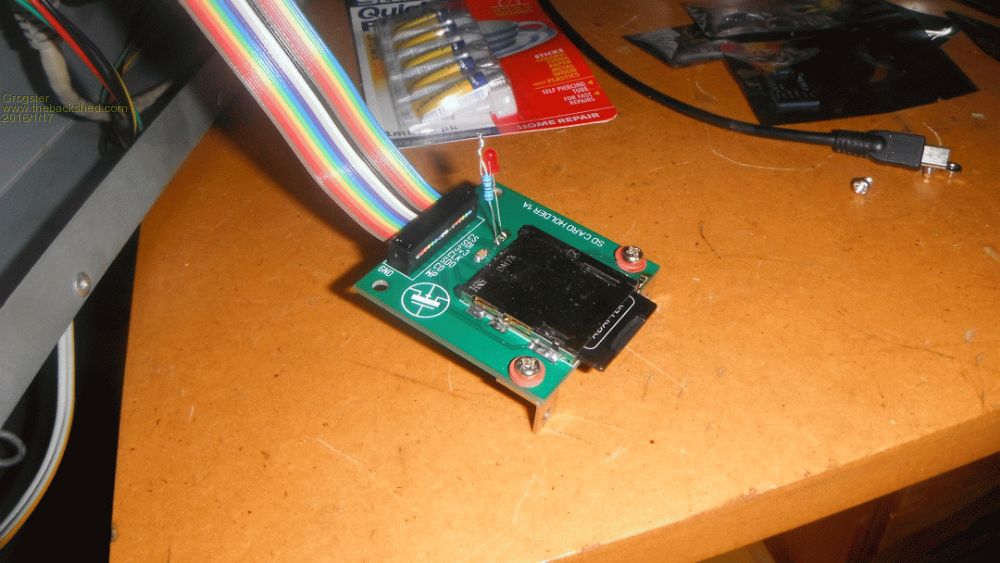

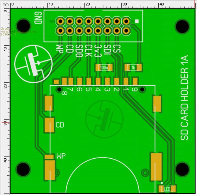

I'm using a 1206 SMD LED. I have removed the LED and the 1k pullup for now, but I will perform the following test:
1) Replace the LED and 1k with new ones
2) Reconnect to the MM+
3) Connect the CS line to a standard I/O pin
4) Set that pin low to hold the CS line low.
At this point, the LED should be lit, and I will measure the voltage on the CS pin on the SD-card socket with respect to ground.
EDIT: Here is a shot of my SD-card carrier. I note I have forgotten the 100k to deck you have on your design.... Would this be the cause?

Also, I note your R11 is a pullup to CD2, not deck, so ignore what I said about that.

i'm pretty sure that pin 2 of J2 should be connected to the other side of the LED. that is, the -SEL output from the MX470 connects directly to pin 2 of J2, and an LED in series with a resistor (3k3 recommended) is connected between 3v3 and -SEL.
rob :-)

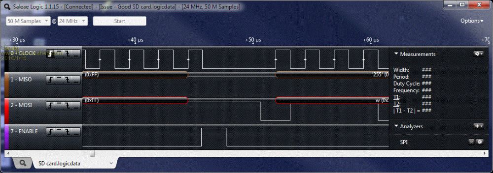

you don't perchance have a digital scope there do you? it would be interesting to capture the -SEL (CS) pulse happening, along with the SPI clock line to see how much leeway there is between the -SEL signal being asserted and data communications with the card starting. similarly, the time between communications finishing and -SEL being released.
my suspicion is that (a) -SEL is controlled entirely at the discretion of the MM firmware, and (b) that the timing is a tad tight at one end or the other. note that different SD cards will have different requirements regarding the margins required - so whereas some cards may be ok, others will fail to function. i have seen such problems in a real-world product that a company i worked for shipped out to customers. our solution at the time: customers were told they should only use cards 'certified' (and sold) by us!
if it is just a timing issue, it can almost certainly be fixed by geoff with a few strategically placed NOP instructions.
