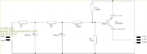

  Quote  Please can you elaborate more i.e. can you provide circuit details/values
Standard transistor biasing. i.e. keeping the transistor in its linear operating range. Note the aggressive RC filter to smooth the slow pulse
This works on the breadboard. The circuit is inverting so 16 is dark and 0 is light
UPDATE What governs the size pictures appear on the BB? Mine always seem to end up small
Values are:
R1, R2 1K
R3 330R
R4 150R
R5 18K
Caps 100uF
PNP transistor 2N2907
Edited by matherp 2015-11-11

Thanks for your methods posted here. From your explanation I guess 500Hz is not going to be achievable without a lot of work and/or a radical rethink. I am happy with the method I have resorted to apart from the fact it ties up one of the two PWM channels.
