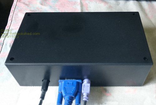

I based it on a Colour Maximite from Circuit Gizmos ( thanks CG ), because it had the build in real time clock and the "sea of holes" for the extra circuitry. The board was fitted into a plastic case from Jaycar, with the VGA, PS2 and Power connectors on one side, and access to the SD card on the other.

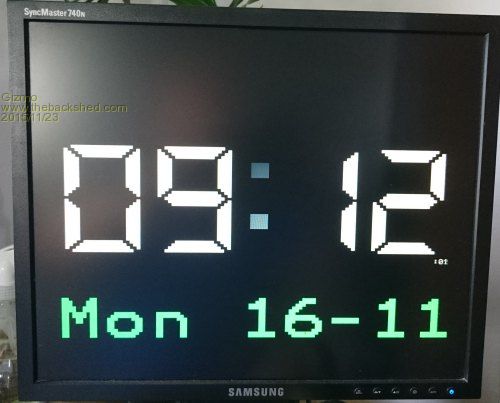

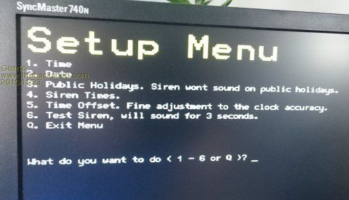

The software is not well written, bit old school, but it works. The main screen displays the time and date. Hitting any key brings up a menu, where you can set the current time and date, time offset, siren times, holidays and a test function. If any of the screens are left open for too long, the watchdog resets the chip and the program restarts.
Setting the current time and date is obvious. You can also set up a few dates that you dont want the siren to sound. Used for public holidays.

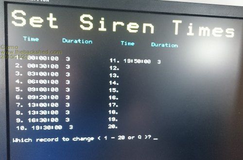

There are 20 siren time slots per day, and you can have different times for different days. The siren duration can be set from 1 to 5 seconds.
The time offset screen lets you change a value from -999 to 999, in milliseconds, that is applied to the clock just after midnight. This happens 15 seconds after midnight, as at midnight on the dot the siren needs to sound, so didn't want to clash with that event. At 10 seconds after midnight the software reloads the main screen to update the displayed date, etc.
