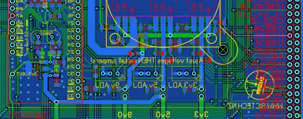

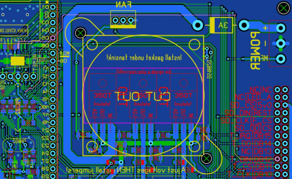

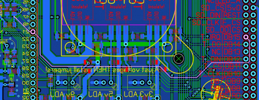

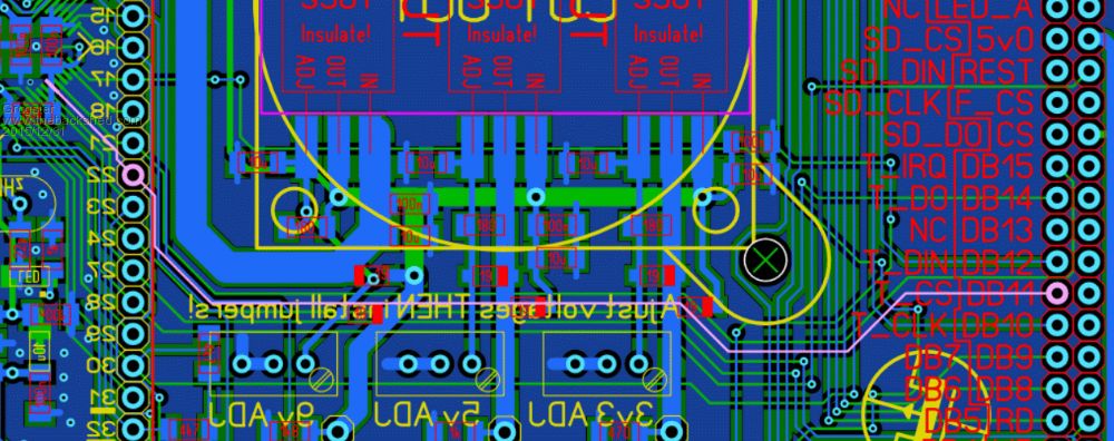

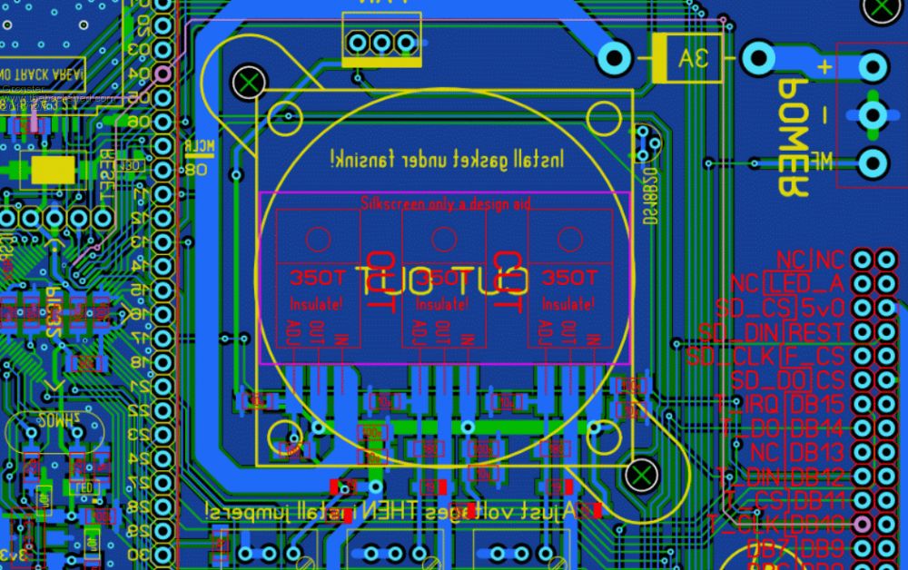

Images of the track layout: (Relevant track in each image is highlighted in pink)
Everything looks just fine to me, so I don't understand why as soon as you run the touch command, the MM+ falls over.
Can anyone else throw any light on what might be going on?
