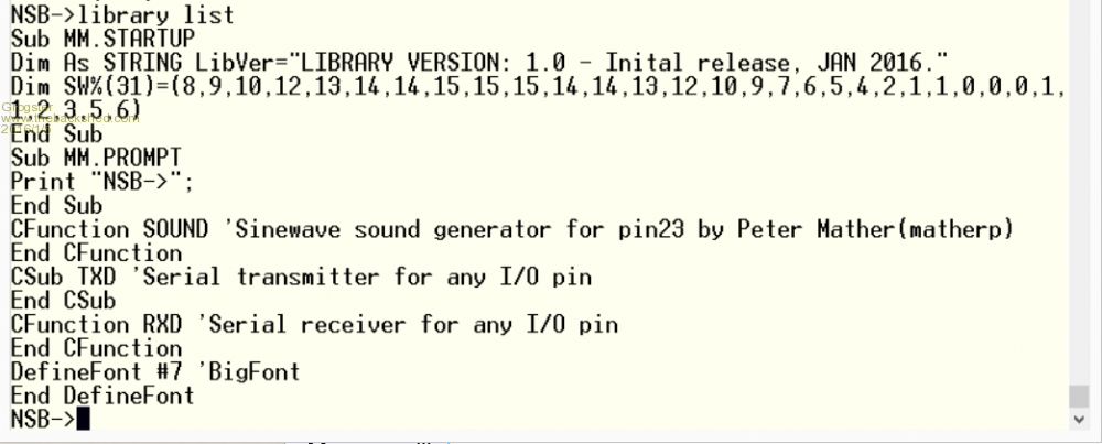

In another thread, Geoff writes:
  Geoffg said  The Subroutine MM.STARTUP is run when the Micromite first powers up. So it is useful for things like printing a message or loading TFT LCD drivers as PeterM does. It is NOT good for general setup of MMBasic (like dimensioning arrays, the LCD INIT command, etc).
In my library, I do DIM a couple of things needed by the library.
One is a wave-table for matherp's sound Cfunction, and the other is a variable to ID the version of the library currently installed:
As this would seem to be perhaps a no-no, is there any better way to do it?
As you can see, SW% is needed as this is the wave-table for matherp's Cfunction, and LibVer is a string that can be called and shown on the LCD to show the version of the library in use.
This is all working just fine, but I am concerned with Geoff's comment from the other thread, so any suggestions would be good to have now, rather then later if this kind of thing is likely to cause obscure bugs later on.

I believe that the post that you referred to explained it fully. Don't define your variables in MM.STARTUP but instead as normal code in the library.
I bet that you also have autorun turned on. That does not reset everything like RUN does because it assumes that the processor started in a clean state. So this explains why your program works OK. BUT, if you did start your program with the RUN command it would fall over.

I can move the wave-table to the main code no problems.
The library ID needs to be saved as part of the library, and NOT in the main code, so that it can be referred to from the main code. If I put it in the main code, the library could be updated later, and the main code would keep saying the library was version 1, if you see what I am getting at.
Is there a way to do something like that in the library that does comply with library specs?

In the library before the sub,
DIM as STRING LibVer
In the sub
LibVer = "Version 9"
As long as it's DIMed outside the sub, the main code will see it.

@ Rob - You are correct. To save a new library, you have to erase the main code. In my case, I am using the library to hold several Cfunctions rather then having them take up considerably more memory if listed in the main code. The version number variable is the only exception, really.
It's for precisely that reason, that I need to know what is in the library - my 'Version number' string. If you do a new main code, and it does not need any new Cfunctions in the library, no problems. If you do a new code that DOES need another Cfunction, I guess you could just plop it in the main code, but compressing it in the library is a much better idea.
I too think that putting general commands etc in the library is of little use.
I guess at the end of the day, I don't even need the library version number, as LIBRARY LIST shows all the Cfunctions or Csub's stored within, so - meh........
Perhaps a whole lotta nuthin', my wanting a library version variable.

One problem is that your program is in an image which I cannot edit to illustrate how it should be done. So, the below is an abbreviated version as I am a slow two finger typist.
If you had this in the library:
DIM AS STRING LibVer = "... etc ..."
SUB MM.PROMPT
etc
END SUB
CFUNCTION etc
etc
etc
The variable LibVar would be visible to your running program. I believe that the issue is that you tried PRINT LibVer at the command prompt and saw nothing. The reason is that the library code is only run before the main program but not at the prompt.
One way out of that would be to define LivVer in both the library code and in MM.PROMPT. For example:
