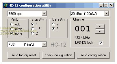

hi,
for anyone who is interested, attached is a copy of an HC-12 graphical configuration utility i've been working on. i have also edited the HC-12 user manual into a more 'english' form that is hopefully a little more understandable.
the HC-12 module can be had for less than us$10 (including delivery) for a pair on ebay. of note is that configuration is saved in onboard flash, so you can configure a pair of modules once and thereafter pretty much treat them as a 3-wire TTL serial data cable that can be up to 1800m long (on a good day with a tail wind).
feedback and corrections to any errors are welcome.
rob :-)
2016-01-12_042418_HC12_config.zip

You can't select above channel 4(434.6MHz) - is that by design?
I am guessing you wrote the utility, to not allow setting of illegal frequencies for our Australian/New Zealand regulations, but that also means that other people from other countries can't select a frequency that they might be able to use.
I don't care, cos I stick to the regs, but others might need that flexibility.
Nice easy to use utility, Rob, and I think I might even get in a couple of those modules to play with. I don't suppose you know what the spectral cleanliness is like on these modules? I have a 2GHz spectrum analyzer, so I can check the carrier for harmonics, especially at the 100mW power...
Posted: 02:39am 12 Jan 2016
  Grogster said   You can't select above channel 4(434.6MHz) - is that by design?
you see that little check box marked "LPD433 lock"? try unchecking it
i would be extremely interested in any RF testing folks could do, so as to be able to expand on the user manual. also, please do report any spelling errors spotted (in config utility and user manual). i'm already up to version 2.3B of the manual after re-reading it a few times.
i am also keen to hear how well the serial port enumeration works. i'm reading the windows registry to build the list of ports and am not 100% sure how well it detects real serial ports.
rob :-)

D'OH!
My bad - I wondered about that checkbox, but did not think to untick it - silly boy.(me, that is)
Looking at the photo of the module in your manual, it looks to have some kind of output RF filtering, but how good or bad it is, does depend on what the spectrum analyser makes of it. I will get a couple in from eBay and hook one up and post the resultant waveform + any other data. This is not exactly lab-testing that is done for compliance, but it would give us some kind of idea of it's spectral output purity.
