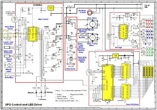

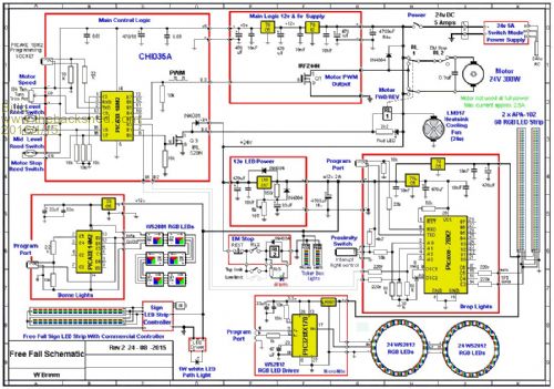

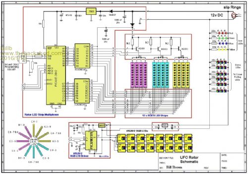

Hi Frank
What other info would you like to know?
Below is a number of schematics for two of the carnival rides.
Thanks to all for your comments.

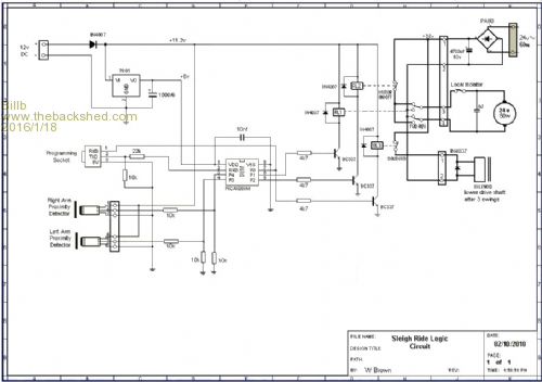

How is the Santa's Sleigh device propelled? I like how it just barely goes over the top.

Hi Hank
The Sleigh acts like a pendulum With a motor driving a
rubber roller in the base giving it a kick each swing.
The motor direction is controlled by a picaxe 08m with two proximity
switches at the top to detect the arms as they pass.
Schematic of the motor drive.

Very clever, Bill. Thanks for explaining how it's done.
