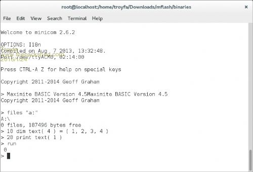

I updated MMBasic to version 4.5 for the Maximite/Minimite using mphidflash.. after the update I have noticed that the DIM statements aren't working for some reason..
heres a screen shot...
10 dim text( 4 ) = ( 1, 2, 3, 4 )
20 print text( 1 )
run
0

Hi and welcome to the forums and MMBasic
V4.5 does not allow you to assign values to arrays when DIMing them
DIM TXT( 4 )
FOR n = 1 TO 4
txt(n) = n
NEXT n
PRINT TXT( 1 )
TEXT is not a keyword in V4.5 but is used in later versions for the micromite.
It would be safer to refrain from using TEXT as a variable name (but does not cause problems for now)
You can forget about using line numbers. They still work in V4.5 but it is better to learn to leave them alone, the sooner the better.
Seeing a double signon is not a problem, just a quirk of Linux and the USB-serial initialization. Windows users see that sometimes too.
