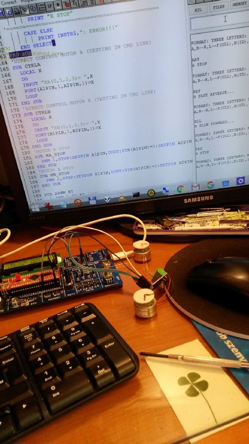

Hello
I purhased in ebay mot-ctrl
and here the test program:

Here is photo:

btw: whats the blue board ?
