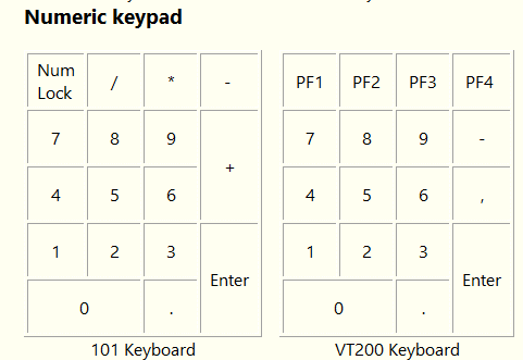

Configuring TeraTerm NumPad for MMBasic
Teraterm can be configured handle the keys on the NumberPad in two ways. If configured as VT220 shown below then the NUMLOCK,"/","*" and "-" send escape codes that are interpreted by MMBasic as the F1-F4 keys as
reported here
  mozzie said
The "NUMLOCK" key works as "ESCAPE" (Actually its F1)
The keypad "/" key works as "F2" / RUN
The keypad "*" key works as "F3" / LIST
The keypad "-" key works as "F4" / EDIT
File KEYBOARD.CNF contains the keyboard mappings.
Teraterm 5 appears to set the NumberPad correctly and NUMLOCK,"/","*" and "-" work as expected.
Teraterm 4 at installation will copy EDITOR.CNF to KEYBOARD.CNF
This sets the function keys (F1-F12) correctly but sets the NumberPad incorrectly.
The file FUNCTION.CNF has the correct settings for the NumerPad. Copy the section below to replace those in the KEYBOARD.CNF file.
[VT numeric keypad]
;Num pad 0 key
Num0=82
;Num pad 1 key
Num1=79
;Num pad 2 key
Num2=80
;Num pad 3 key
Num3=81
;Num pad 4 key
Num4=75
;Num pad 5 key
Num5=76
;Num pad 6 key
Num6=77
;Num pad 7 key
Num7=71
;Num pad 8 key
Num8=72
;Num pad 9 key
Num9=73
;Num pad '+' key
NumPlus=78
;Num pad '.' key
NumPeriod=83
;Num pad Enter key
NumEnter=284
;Num pad '/' key
NumSlash=309
;Num pad '*' key
NumAsterisk=55
;Num pad '-' key
NumMinus=74
