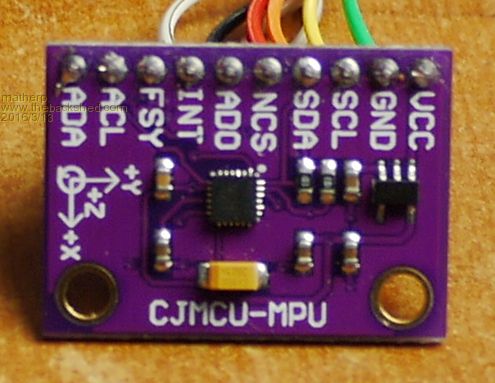

The MPU-9250 is a 9-DOF Motion tracking device comprising 3-axis accelerometer, 3-axis gyro and 3-axis magnetometer.
It is comparatively cheap given the functionality provided.
It provides all the input required to monitor and maintain the position of an object in 3-dimensional space and is typically used in the the attitude reference system (AHRS) in things like drones.
The attached code provides all the functionality required to calibrate and operate the device as well as providing a sensor fusion engine to integrate the 9 readings into a single representation of the orientation of the sensor.
The MPU-9250 actually contains 2 separate devices on the chip's die. The MPU-9250 itself does the acceleration and gyro measuremnts and there is also an integrated AK8963 magnetometer.
To use the device the module must first be calibrated and the calibration parameters noted and included in the code
' Calibration parameters for gyro and accelerometer
dim float gyro_Bias(2)=(40,15,100), accel_Bias(2)=(340,55,-390)
' calibration parameters for magnetometer derived from running AK8963calibrate
DIM float magbias(2)=(17.2,-23,28), magscale(2)=(0.905,0.92,0.90)
The magnetometer is calibrated by running the first attached program. Basically you need to move the module through all possible orientations over about a 30-second period and the algorithm will then print out the calibration parameters.
The gyro and accelerometer are calibrated by removing the comments from the following section of code in the main program at line 140. In this case the module should be placed on a level surface and kept completely still while the calibration runs.

The main program includes debug "TEXT" output to a TFT display. This is enabled or disabled by setting the constant "screenIO" to 1 or 0 in line 20.
Full details of the connection of the MPU9250 to the Micromite are given at the top of the main program.
Although the code seems complicated the main program loop is actually very simple
