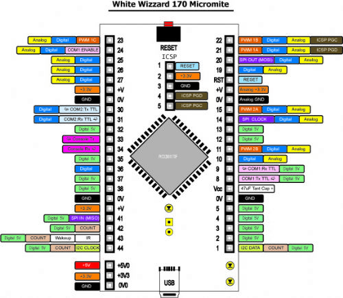

The attached diagram of WW's little 170 board was created for my own use but if you can use it, please do so. I have a vector .pdf if you need to scale or alter.
I am also working on your microkit and microboard boards and Zonkers DIP-600-28 and also Grogsters Explore 64 in the same format and will forward when complete.
Cheers,
Doug.

Panky - yeah, I'll need a better resolution for that.

Thanks Doug for sharing your 170 diagram. I've made a few attempts at keeping all those details under control in my creaking brain, but your design really works. Great stuff!
