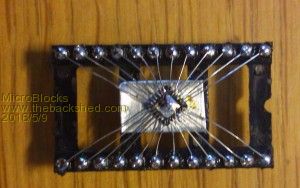

Cheapest way: Do it 'dead bug' style.
Take an 8-pin DIP socket,lay the chip on its back and solder thin wires to pins. Maybe add a drop of glue or double sided tape to prevent the chip from moving around.
Like this (but then with an 8 pin DIP socket):
Edited by MicroBlocks 2016-05-10

The dead bud method may cause a problem with the humidity sensor window on the top of the HDC1080.
