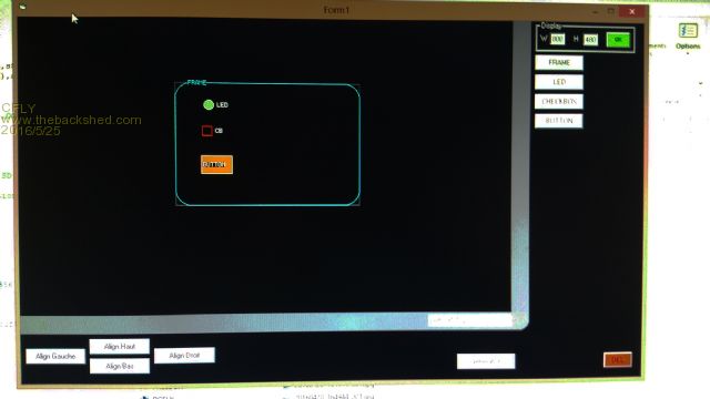

I am creating an application to help in the positioning of the graphic objects (GUI BUTTON, GUI LED, ....).
This application is under PC in VB6.
But I cannot have the same font...
Is it possible to have the same Micromite+ font to install on the pc ?

Posted: 01:10pm 25 May 2016
Interesting ... but I have never used this method and I do not know how to make.
I have just tried with the font "Courier 8" and it is almost perfect (except for the form of the characters).
