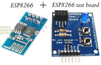

Reason I ask is I have this board:-
The two switches on it pull Reset & GPIO0 low.
It seems unfeasible to be holding the GPIO button down for the entire flashing process.
Just doesn't make sense to have a momentary switch if in reality a latching one is required.
Holding it down while pressing the reset "Seems" to result in successful flashing, according to the flash logs.

Just tried flashing an unused ESP8266 with this board & all went successfully.
Seems GPIO0 only needs to be held low on reset to enable programming mode.
