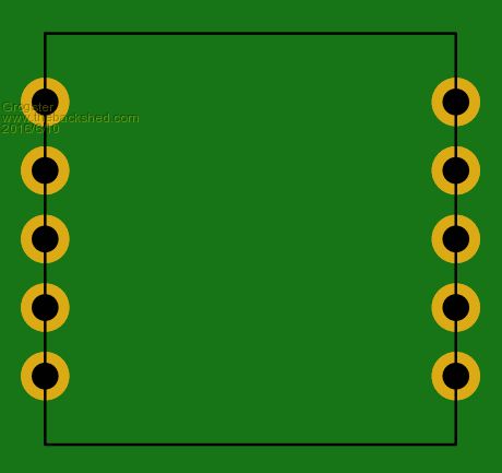

I have done this on boards before, and I just use normal vias, but ensure that the outline layer cuts right through the middle of them:
This has always worked for me on the times I needed to do that.
Probably not the best way, but it does work. Once cut, the semi-circle remainder of the via becomes the solderable edge of the board.

Did you cut it yourself or did the PCB manufacturer do it for you?
Posts: 10072
Posted: 11:54pm 09 Jun 2016
PCB manufacturer. They just slice the board where the outline is, and that was right through the middle of the vias.
