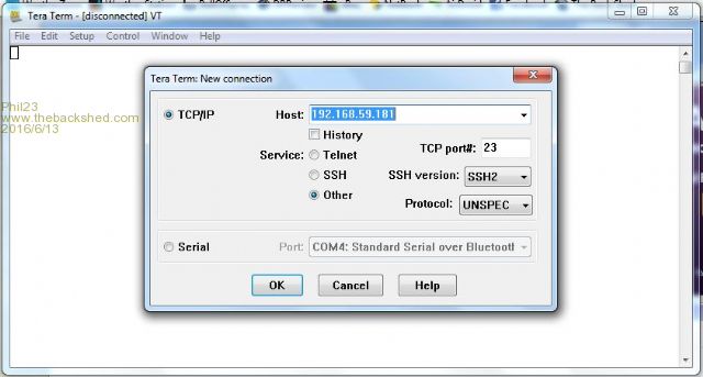

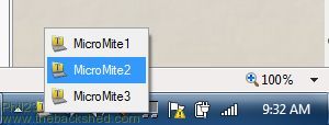

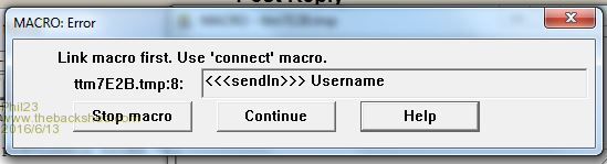

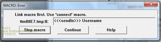

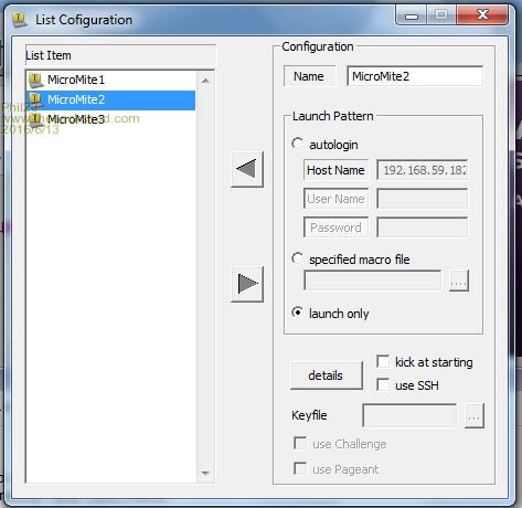

Hi all,
Can anyone hep out with this annoying Tera term issue.
Well more accurately Tera Term Menu.
I've search for answers 1000 times, & only see obscure information.
Seems like there is a temporary macro created.
I can just hit stop macro & it goes away, but surely there's an easy fix.
Hopefully the screen grabs explain it.
Phil.

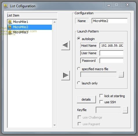

Posted: 02:32pm 12 Jun 2016
You are trying to login automatically when you start.
TeraTerm is looking for the USERNAME prompt.
Try 'Launch only'

Hi Jim,
I had previously tried "Launch Only", but it does not seem to pass the IP address to Teraterm.
Tried it again just now & same result.
It just presents me with a new connection window with 192.168.59.181 as the only option in the drop down list.
On Autologin it connects to the correct IP, with the error in a background window.
The macro file seems to be a random name. Like ttm7EB2.tmp in this instance.
The error on exit says "Link Macro First". which makes no sense with a tmp file.
It's no biggie, I just click past it.
Just find it rather annoying when software has these little issues & solutions are poorly documented.
Cheers.
The MM's are on 181,182, & 183.
The help on this is really poor everywhere I look.

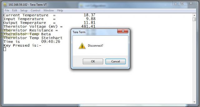

Just wondering what I "Don't Get" with Teraterm....
It's receiving data fine for display purposes.
But doesn't seem to send characters without the enter key.
I have some code that reads the keyboard buffer for a menu....
[Code]
KeyPress = INKEY$
ChkCon
Sub ChkCon
SELECT CASE KeyPress
CASE "m","M"
DoMenu
CASE "1"
If MenuUp=1 Then PRINT "Changing Target Temperature"
input "Target Temperature";TmpTar
Print "Target Temperature Set to:- ";TmpTar
CASE "2"
If MenuUp=1 Then PRINT "Changing Differential"
input "Temperature Differential";TmpDif
Print "Temperature Differential Set to:- ";TmpDif
CASE "3"
If MenuUp=1 Then PRINT "Changing Solar Level"
CASE "9"
If MenuUp=1 Then
PRINT "Stop & Shutdown"
END ' only end program if menu is showing
End if
CASE "0"
If MenuUp=1 Then PRINT "Exiting"
EndMenu
END SELECT
[/code]
Works fine in MMChat, but not Terterm.
Teraterm does not seem to send the character, like "m" for starters, unless I hit the enter key after m.
What do I have configured wrong.
It's a TCP/IP connection I'm using.
