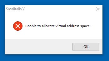

Tried to fire up MMedit today and got the following error message -
Uninstalled and re installed but same problem.

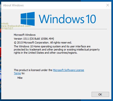

Installed on following system (64 bit machine.....No probs up till now)-

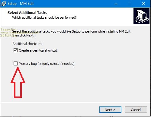

You could try reinstalling again but this time select the Memory Bug Fix option.
There is no need to uninstall.
This will leave you with the old TKN file which doesn't like the new larger syntax files.
You will then have to replace the TKN file with the one I posted here on 9th July.
A quicker alternative is to replace the two files (in the program folder) with the ones in this ZIP.
http://www.c-com.com.au/stuff/XPfix.zip
This method changes the bug fix EXE and also updates the TKN file to the latest beta which is happy with the V5.2 syntax.
Explanation:
MMEdit is written in Liberty Basic. The last update to LB included a larger memory model and this was good because it allowed for much better speed in things like the Chat window.
Unfortunately, it also caused problems on some user systems with the way Microsoft allocates memory.
The fix was to give the effected users the option to revert to the old small memory model.
The author of LB has been promising to release a version of LB with an intermediate memory model and I have been hanging out for it for far too long.
I don't want to revert everyone to the small memory model.
Rebooting Windows and starting MMEdit first is one way of improving the odds but I don't consider that a viable instruction to offer anyone.

Uninstalled and re installed with the 'bug fix' option.
Seems to be all good now. Thanks very much.
