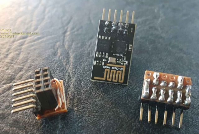

Nothing spectacular & I've seen other ideas, namely 8 pin DIL adaptor,
to make these things more breadboard friendly.
Could do all 8 pins in a similar fashion, & the wire links aren't necessary,
but they put the pins in an order I preferred.
Rx - Tx - CH_PD - Reset - Vcc - Gnd.
The DIL example looked a pain to solder on single sided board, this was a piece of....
