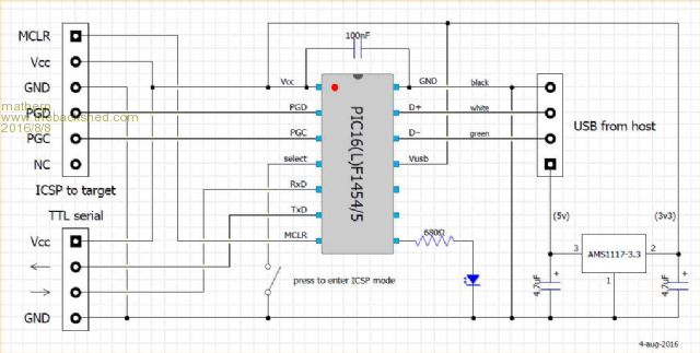

You don't need one of these boards though as the chip can easily be breadboarded. The attached circuit was prepared by Robert Rozee, the author of the ascii implementation of PIC32prog who has also provided much help during the development of the code.

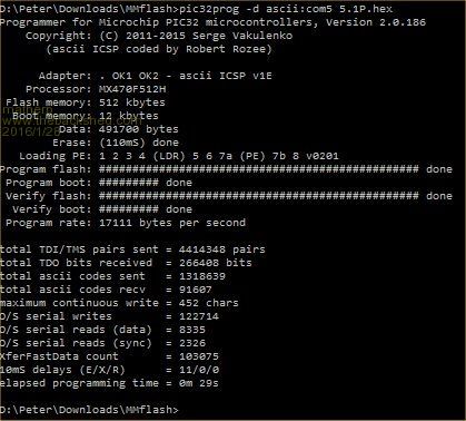

To program a PIC32 chip connect up the ICSP connections as in the diagram and briefly short pin 4 to ground (the switch in the circuit diagram). The LED will light showing the chip is now in programming mode. Make sure you have the latest version of the Pic32prog software from here.
Open a command window and use the command line:
pic32prog -d ascii:comxxx nnnn.hex
where comxxx is the com port that has appeared when the USB cable was connected and nnnn.hex is the firmware you wish to program into the PIC32.

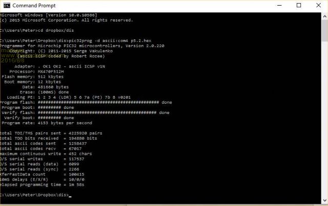

The attached show a typical programming session:
Once the PIC32 is programmed the PIC16F1455 software will automatically revert to USB/UART mode and the LED will go out.

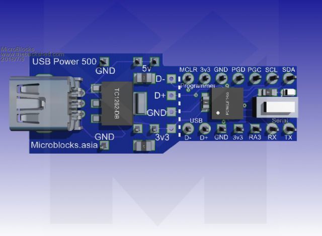

They have been send to the pcb manufacturer (slightly different as above picture as it has through hole caps and resistors and a TSSOP package for the chip that makes handsoldering easier. I expect them to arrive in about 10 days.
The price will be $3US for the bare pcb and $9.95US for a kit including all the parts (also preprogrammed chip).
They will probably also be for sale through Dontronics/Mick to have faster shipping.
From Thailand it is not more expensive (about $2US) but it takes anywhere between 10-28 days to arrive.
I also have another board that will arrive in the same time that is more like a programmer and an adapter board for 28 pin DIP.
They will be $5US for the bare PCB(both pcb parts)and $11.95US for a complete kit.
It is the same pinout as the 'Free' version by Matherp. If you already have a pickit 3 then you can use that version also. A kit is then 2US$ cheaper as you will then get an empty chip you need to program yourself.Edited by MicroBlocks 2016-08-10

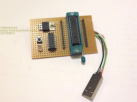

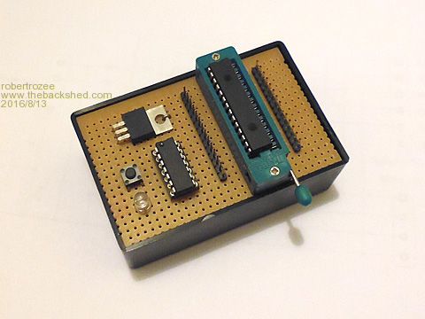

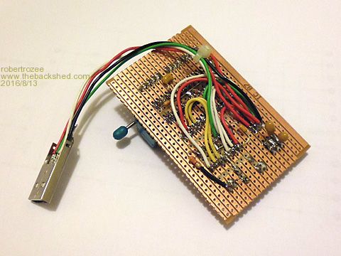

below are pictures of a built-up unit using peter's .hex file. programming an MX170 under XP is marginally quicker than using the original arduino NANO design (1m 43s versus a tad over 2 minutes), and the serial interface side of things works fine. the 1455 was recognized without any intervention, as some time ago i had loaded up the microchip .inf file containing their vid/pid pairs. i believe that under windows 7 and later this is built in.
one major advantage offered over a regular usb-to-serial bridge is that under teraterm one can now press alt-B to reset the micromite, no need for a separate reset switch.
someone may wish to take the form-factor i have used and turn it into a PCB for folks to purchase (fabrication cost would be about USD 0.60). the board is sized to fit in place of the lid of a small jiffy box, 79mm x 50mm. if laid out more compactly a mini-USB socket could be placed on the board to the right of the micromite, this makes a nice fully self-contained experimenters setup.
rob :-)
Edited by robert.rozee 2016-08-14

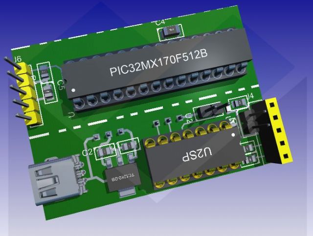

Hi All,

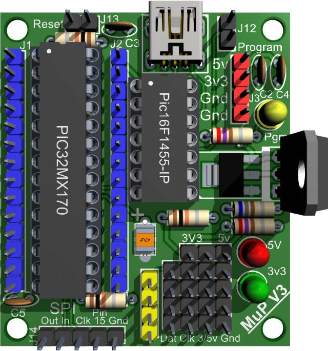

Of course a board similar to Robert's vero one does already exist..
My MuP3 - Full details located here
It is smaller than the above Vero unit at 49.5mm x 43mm (1.95" x 1.69")
It supports either MicroBlock's U2SP-DIP chip or Peter and Robert's Free ware chip.. I can supply either if you can't burn your own.
Kind Regards,
Posted: 04:18pm 13 Aug 2016
good point, i forgot the MuP3. although, having a ZIF socket and a jiffy box protecting the back of the board can be useful.
incidentally, i've found that the cheap ZIF sockets found on ebay (from china) can be very hard to get to solder nicely. extra flux and a hot iron were required in the end.
rob :-)

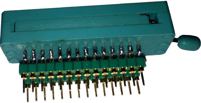

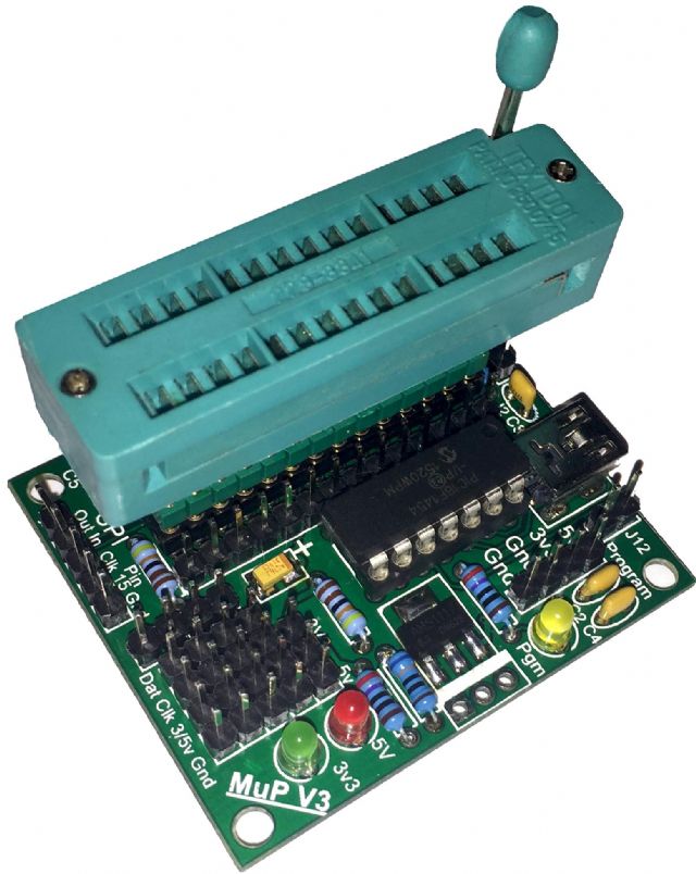

Posted: 05:49pm 13 Aug 2016
Rob, All,
As the pins of the ZIF sockets are too wide to plug into a normal socket, I have extended mine, using double ended round pins, like this.
Here is a shot of it plugged into a MuP3 ready to go.
As to protecting the bottom of the board, all you need there are rubber bumpers/feet added to the underside of MuP3.
Kind Regards,
MickEdited by bigmik 2016-08-15

To program I use Win7 PICKIT3 programmer and usually have no trouble in PIC32MX170 schedule.
I mounted on a breadboard circuit diagram at the top of this article and simply
the PICKIT3 not recognize the PIC16F1455, it is as if the chip is not connected.
Reviewing different schemes on the net I can see that the lines of PICKIT3 are connected in this way and
I make this connection assembly
PICKIT3 .............PIC16F1455
Pin_1 ---- MCLR --- Pin_4
Pin_2 ---- VDD ---- Pin_1
Pin_3 ---- VSS ---- Pin_14
Pin_4 ---- PGD ---- Pin_10
Pin_5 ---- PGC ---- Pin_9
Pin_6 - nc
Power suply 3v3.
I realize this assembly and then IPE Microchip PIC16F1455 can recognize without problems.
Then charge the HEX file and produces no error.
I want to believe that it has been properly programmed.
File used "PIC16F1455V1.08.hex".

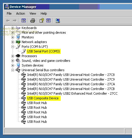

Now I connect the PIC16F1455 on my breadboard with this chip and I can not communicate with Teraterm.
The PC detects a "USB Composite Device" and leaves an alarm with a triangle and an interrogation.
