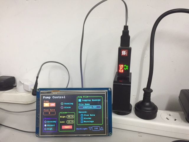

Also noticed Geoff mentions around 500mA with a 5".
Measured what mine was drawing yesterday, with just RTC & screen,
All that was running was the pump demo.
Got 490mA on a USB ammeter.
Didn't try turning brightness down,
got side tracked by the fact that the USB Com12 wouldn't work.
Turned out the PC was shutting down the ports data service at the level of current draw.

Strongly advise using a PSU rather than a computer port when using an E100 with a TFT connected (no matter what size TFT).
It is worth obtaining a Raspberry Pi official PSU - they are cheap and of decent quality; and will deliver more than enough current for a 'loaded E100 set-up.

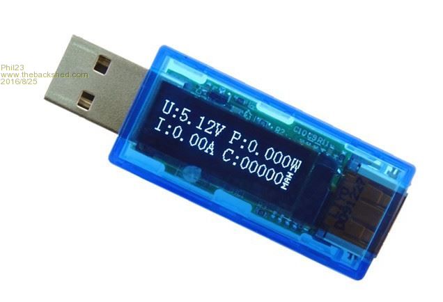

  WhiteWizzard said   Strongly advise using a PSU rather than a computer port when using an E100 with a TFT connected (no matter what size TFT).[/quote]
Yeah I usually do.
It was just a quick & easy way to measure current with one of these:-
It was handy; no effort required, Lol.

Posted: 07:26pm 24 Aug 2016
That's a nice looking one Phill. Beats my LED one.
