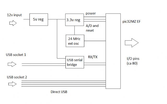

this is a test to see what simple png schematics display like..
eg sn-7x board overview :
