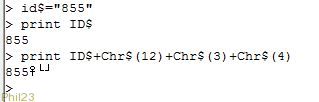

[Code]> dim id$ as string
> id$="855"
> print ID$
855
> print ID$+Chr$(12)+Chr$(3)+Chr$(4)
855
[/code]
It actually shows up differently on the screen, as far as the 3 low order characters go.
Why are you trying Chr$(8) 5 5 etc wouldn't this be correct?
[Code]> print Str$(8)+Str$(5)+Str$(5)+Chr$(12)+Chr$(3)+Chr$(4)
855
[/code]
