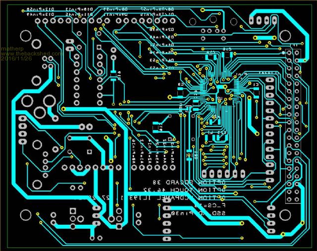

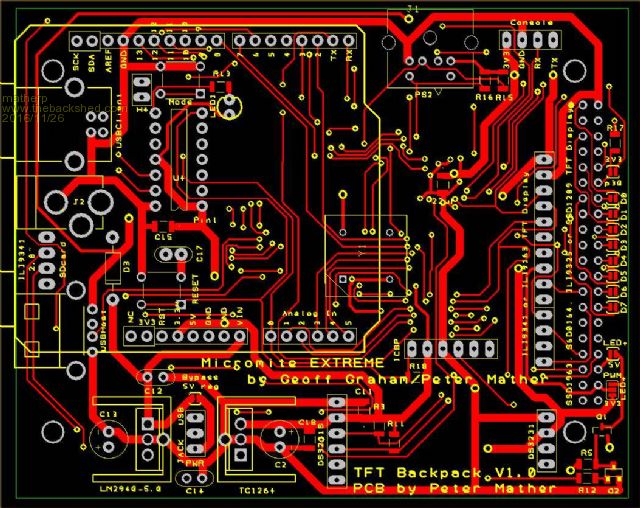

All feedback appreciated before I go to copper. I will of course post the gerbers as soon as I'm happy they are OK

My comments/questions:
1> What are the mm dimensions of PCB?
2> The mounting holes look very close to 'things' - may not allow screw heads/bolts to be used?
3> Is there an onboard uSD socket - can't see one - but my eyes are going bonkers looking at this!
4> How many PCBs would you get made? I am happy to offer these as part/fully assembled - so possibly bring down PCB manufacture unit cost for you.
5> Could you send me larger format diagram to save my eyes?
6> How soon?
7> Any chance of a 100pin version too
WW
Posted: 02:18am 26 Nov 2016
Could you make the console a 5-way by adding a 5v pin? I know this could add 'power issues', but smart use of jumpers can resolve this.
The reason for asking is that the unit could then be powered by a single cable/connection to the console header. Just a suggestion . . .
Posts: 12040
Posted: 07:10am 26 Nov 2016
100x80
  Quote  The mounting holes look very close to 'things' - may not allow screw heads/bolts to be used?
I've now improved this for at least three of the holes. The holes match the 3.2" SSD1289 display. Anything bigger breaks the 10x10 limit for v-cheap PCBs
  Quote  Is there an onboard uSD socket
No, the expectation is that the SDsocket on the TFT display is used and the wiring supports this
2016-11-26_170941_Bottom.pdf
2016-11-26_170953_TOP.pdf
How soon?
As soon as Itead make the PCbs
Not on the agenda at the moment. easy to mod the schematic but the layout on double sided takes forever.
DoneEdited by matherp 2016-11-27

Can't follow the OSC circuit. Seems like C19 is between pins 31 and 30. Is this meant to be like that?
Where is the oscillator located on you PCB? Just can't see it even on the bigger format!
Likely to be me missing it, but just raising it . . ..
Posts: 12040
Posted: 08:58am 26 Nov 2016
  Quote  Where is the oscillator located on you PCB?
You are probably looking for something small - it is huge (comparatively) big square box with 4 pins at the corners labelled Y1 on the top diagram
RS 796-0619Edited by matherp 2016-11-27

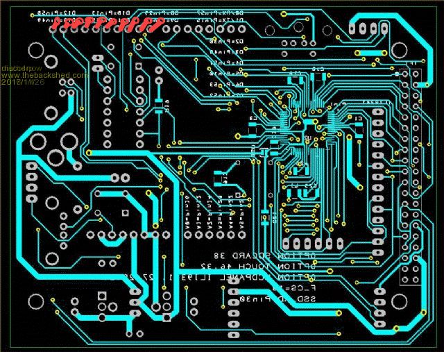

Its probably a bit late and may not fit, but would it be possible to duplicate the
Arduino header pins that are offset by half a hole so the second set is lined up on a normal hole position. This would allow you to use veroboard as well as the arduino shield.
100% Agree Disco. I was about to make the same suggestion, but you beat me to it.
At least I'm glad I'm not the only one that thinks that way.
The Arduino pin offset is always a pain for those of us who build finished project on proto-board. Usually after it living for some months on a Solder-less board.
