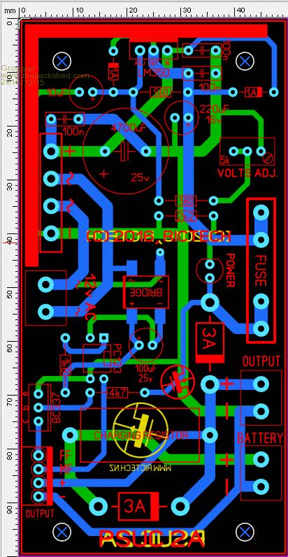

Here is my latest PSU design:
Up to 3A output, fully adjustable and short-circuit protected.
You need to bolt this one's aluminium right-angle heatsink bracket, to a bigger heatsink depending on input-output voltage difference and load current.
This one has transistor buffered mains-fail and fuse-fail lines designed to interface to MM I/O pins via the standard 10k/1k pull-up arrangement. When powered, the mains-fail is a separate circuit on the board via an optocoupler, which pulls the MM input LOW while powered. The fuse-fail is the same concept, but it uses a transistor rather then the opto, as the fuse supply has the same ground as the rest of the circuit being powered - the mains-fail does not, hence the opto isolator.
If the mains fails(or the fuse blows), the artificial pull-down will vnish, and the 10k/1k pull-ups will pull that line(or lines) high, and the MM can pick up on that with an interrupt.
Battery charging is via a simple diode-gate and series charging resistor chosen to TRICKLE-CHARGE a suitable gel-cel. This design DOES NOT allow for fast-charging, and does not monitor the battery. Trickle-charging is fine done like this, but naturally, it takes the battery time to charge up when done like this.Edited by Grogster 2016-12-16
