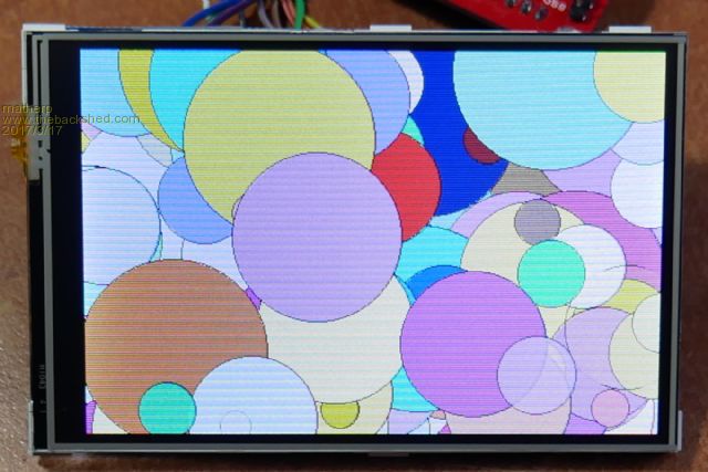

There are quite a few displays now on the market that are designed to work with the Raspberry Pi and these include some higher spec TFTs such as this one which has a 480 by 320 pixel resolution and uses IPS technology which is both brighter and has a better viewing angle than the cheaper TFT panels.

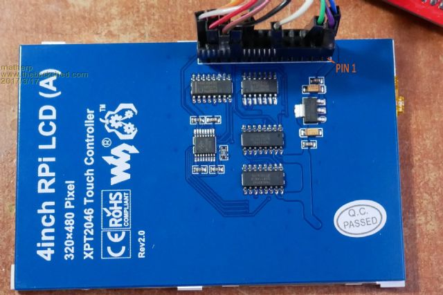

The set up of these is quite interesting. The display itself is run in 16-bit parallel mode but the PCB has a couple of 8-bit shift registers so that it can be controlled over an SPI channel as the Raspberry Pi doesn't have an easily accessible 16-bit parallel port.
The display is very neat with the viewable area only slightly smaller than the PCB it mounts on. It has the normal XPT2046 touch controller so is fully compatible with the Micromite.
The controller on the PCB is an ILI9481 (bigger version of the 9431) and I've included support for this in the MMX code V5.3.14
The command to initialise the display is exactly the same syntax as the ILI9341
OPTION LCDPANEL ILI9481, orientation, DCpin, Resetpin, CSpin
Unfortunately, because of the way the display is wired, transparent text and the BLIT command are not available on this display
The required connections on the 26-pin header are:
Pin-2 5V
pin-6 GND
pin-11 T_IRQ
pin-18 ILI_DC
pin-19 SPI2OUT
pin-21 SPI2IN
pin-22 ILI_RESET
pin-23 SPI2CLK
pin-24 ILI_CS
pin-26 T_CS

Hi,
I am looking for clarification as to the wiring for the ILI9481 LCD screen - specifically the SPI connections on Pins 19 and 21 of the LCD header. As listed above, the signal names appear to be the signals they connect to at the MM end. I just want to be sure this is the correct interpretation and the OUT and IN do not refer to the signals from the LCD controller's perspective.
Thanks,
Phil.
disco4now
Joined: 18/12/2014
Posts: 1158
Posted: 12:37am 17 Oct 2017
The pins I used on an MMX100 are below.
It confirms that the labels given refer to the
the MM end for SPI2OUT and SPI2IN.
The required connections -------My MMX100
on the 26-pin header are:-------pins
Pin-2 5V
pin-6 GND
pin-11 T_IRQ-------------------100
pin-18 ILI_DC-------------------96
pin-19 SPI2OUT------------------66
pin-21 SPI2IN-------------------72
pin-22 ILI_RESET----------------95
pin-23 SPI2CLK------------------10
pin-24 ILI_CS-------------------97
pin-26 T_CS---------------------98
Gerry
