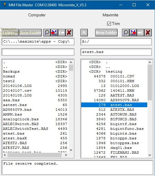

This update includes support for the micromite eXtreme including file transfers.
MMedit’s file manager can be used to transfer any type of file between the PC and the micromite eXtreme.
This should save wearing out the SDcard holder!
The file manager hasn’t had much use since the introduction of the micromites so it might be ‘new’ for some users.
Old users (that's long term , not senior citizens) might notice that I have swapped the PC and micromite over so the micromite file list is on the right. That was a personal preference and I might make it configurable in a future update.
