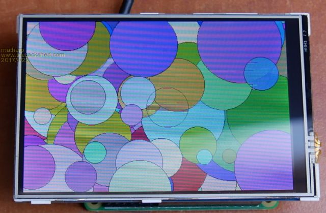

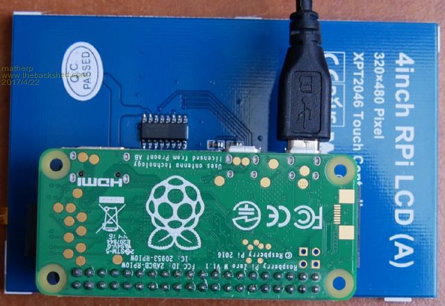

The Pi-cromite code has now been tested on the Pi Zero-W and works nicely.

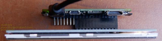

It is seen here running headless with a 4" 480x320 IPS display directly connected.
Configuration for this is:
[code]OPTION LCDPANEL ILI9481, L, 18, 22, 24
OPTION TOUCH 26, 11[/code]

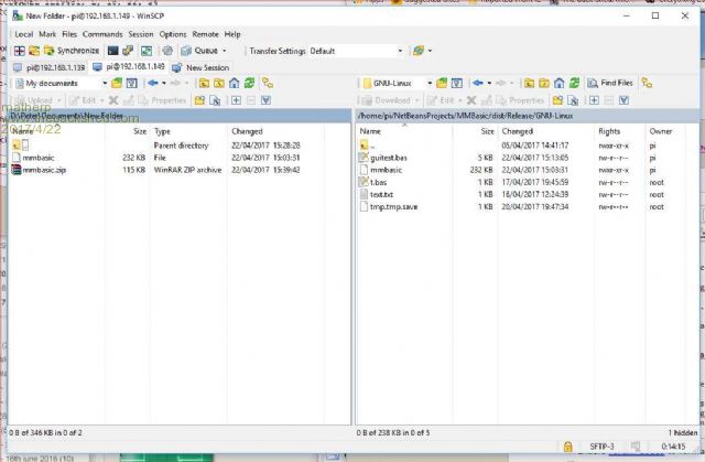

To run headless make sure you enable SSH on the pi using raspi-config and then you can run from a terminal session on any other computer using putty or similar.
The standard raspian build also includes full support for sftp so if you install a client on your computer (e.g.WINSCP) you can transfer files to and from the pi-zero without ever needing to connect a monitor/keyboard/mouse once it is set up.

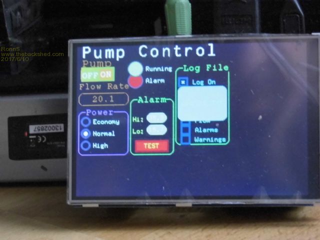

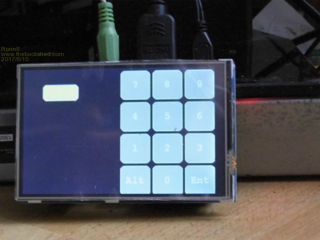

i am thrilled and thankful for the new Pi-Cromite.
In this week I received my 4 inch LCD display and could test the functionality together with the RPi3
Pi-Cromite Basic works well along with the SD card of the RasPi, opening and writing a file is not a problem. And also the GUI functions work
The best is to control everything over wifi
best regards from Germany
Ron
