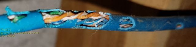

On a completely different topic;
I got to the bottom of an issue with the ongoing reliability of ESP-01's connected to the consoles of some of my Micromites.
I'd experimented with Caps on the power rails; tried different firmware version;
even swapped modules about, but still found I was prone to dropouts on 2 particular units, that were previously stable. The ones in question were even on a low usage AP, possible 3m away & with an RSSI of around -56db.
(Yes, Swapped out that AP with an identical one & switched their config's about).
Cutting that bit out, (about 2m from the termination), did NOT restore the connection.....
Grrrrrrr.
Phil.
Even on a low usage

Rodent or bird???
