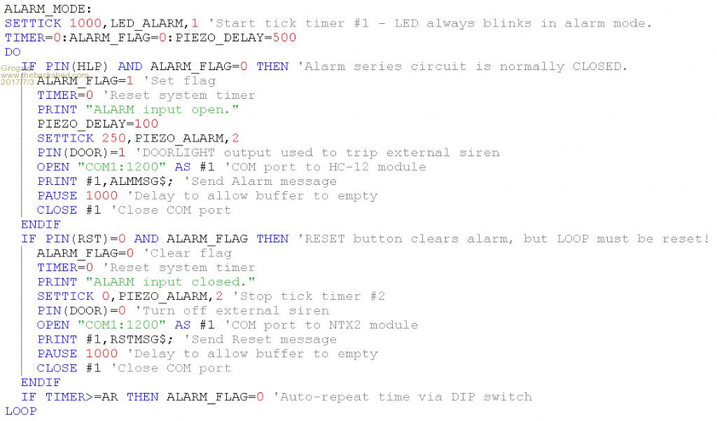

EDIT: Here is the test alarm code that is doing this very odd com-port behaviour.
It is indeed possible, that the HC-12 I am using is crook or something, so I will be checking what is indeed coming out of the MM COM port on the logic analyser tomorrow - perhaps the HC-12 is unstable and is generating the problem internally? Anyone seen that before?Edited by Grogster 2017-07-04

Posts: 10072
Posted: 04:58pm 03 Jul 2017
Thanks for the replies.
Logic Analyser says that all that crud at the end are "Framing errors", most equal to zero.
This is with the logic analyser directly on the COM1 TX line and ground. The wanted data is there, but it is followed up with random garbage.
I will now isolate COM1:TXD and tap directly into THAT and see if I still get the rubbish, as that would mean it IS coming from the MM2 chip, and not the HC-12.
Will keep you all updated.

UPDATE:
OK, Things have settled down now, but ONLY if I leave the COM port open all the time, so open it at the start of the code before the main loop, and never close it. I left the 4k7 pull-up to 5v in place, and with this situation, it is working OK - no rogue bytes.
More testing required, but it IS doing what is expected of it now, both the MM2 and the HC-12, but this was a little bit of a curly one....
Posted: 11:56pm 03 Jul 2017
I am bamboozled why it was happening - I will have a play over the weekend and see if I can get the same and then fix.
For me this is a mental exercise as I always leave the port open... but i am curious
glad you got it working - kept you up too

Posts: 10072
Posted: 04:15am 04 Jul 2017
Yes, I am reasonably confident that the cause was my closing the COM port, but as MikroBlocks says above - once you decide to use the COM port pins, you don't generally use them for anything else, so I guess I am safe enough leaving it open all the time.
My primary reason for closing it, was just to flush the buffer so that every time it went to send some data, you could be sure it was starting at the start, so to speak, and not adding the wanted data, on to the back of something else still in the buffer.
This does not seem to be happening, so I guess perhaps I was worried about nothing there. Time for sleep.

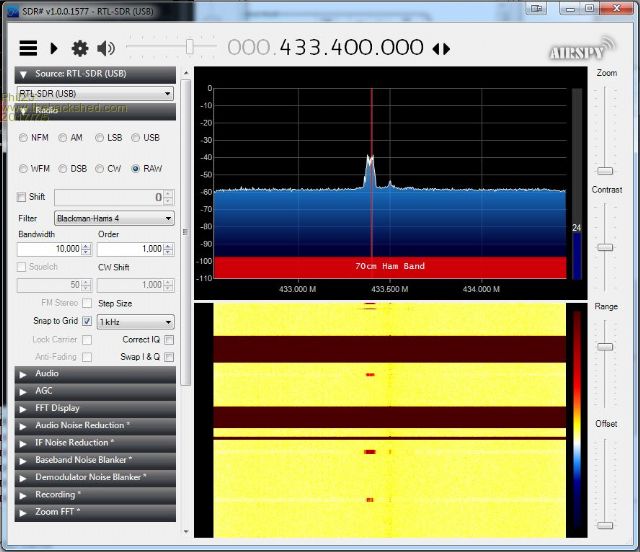

Posted: 07:52pm 04 Jul 2017
Hadn't thought of using my scanner; I've got a similar older Uniden here.
What I do find very useful though is a Software Defined Radio.
Cheap USB TV receiver dongle ;
Then this Software.
Gives me a cheap & dirty spectrum analyser.
A real one would be nicer, but a bit more than $15.00.
