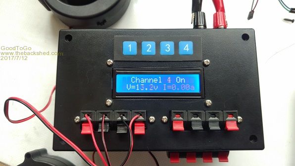

Features
-4 separate 34VDC-12VDC supply 'Channels'
-I2c relay control
-temp monitoring
-variable fan speed control using PWM depending on temperature
-fan supply uses all 12v channels via diode separation
-wireless comms using HC12
-I2c 16x2 LCD display for local monitoring
-LCD Display backlight timeout
-4 local switches for relay on/off/reset/LCD backlight control
-Can run independant of GUI monitoring unit

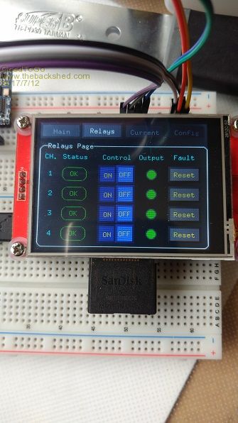

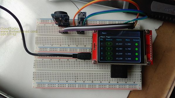

Also, the GUI monitoring unit features
-Wireless comms using HC12
-Overcurrent trip points adjustable
-'Auto' trip point adjusting routine
-SD card logging of all data - time stamped (RTC)
-various displays showing power supply/relay status (OK, TRIP, FAIL)
-GUI LED indication of status (Green ON/OFF, RED for stuck relay ON)
-Voltage/Current/Max Current/ Startup Max Current displays
-Full control of 'slave' power supply unit(s)

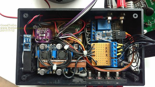

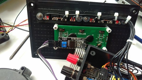

Inside the box:-
It's a mess.
It's amazing how you think you lay something out nicely, but once you throw the point to point wiring in it rapidly becomes a nightmare!
Most modules are ebay sourced.
-relay unit.
-2x LCD I2c modules. (One converted to drive the relays)
-4x INA219 modules (stacked on top of each other) to monitor voltage/current
-DS18B20 temp module (on top of fan)
-HC12 module with a straight wire for antenna (might go back to the spring one)
-Fan driven by TIP120, controlled by the MM
-You-beaut Explore28 module hidden in there somewhere as well
-5x Buck power supplies. (2x2 stacked on top of each other providing 12V, one by itself supplying 5V for MM)
-16x2 LCD module
-Stick on Membrane switches
As far as the GUI side of things goes, well, it's just a MM+ LCD backpack, coupled with an RTC module and a HC12 module.
I have to build two of the slaves units because I have 7-8 inflatables to power on both sides of the garden.

Nice how you made it all fit in the Jiffy box. Well done.
Necessity is the mother of all invention.
It's not overkill. You do it...............because you can.
Regards, Mike B.

I also think it looks quite neat, considering how much stuff you have in there!
