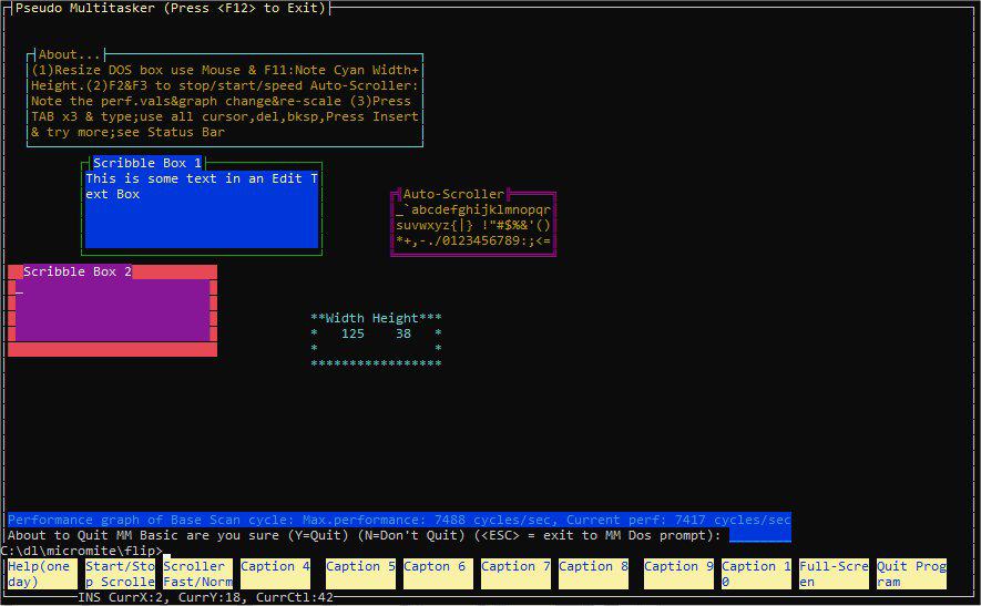

Phil--this is quite fine and fun work. Very compact code, but I could follow it well. It deserves more attention--perhaps screen shots would help. This is what you get when you run the code as-is:

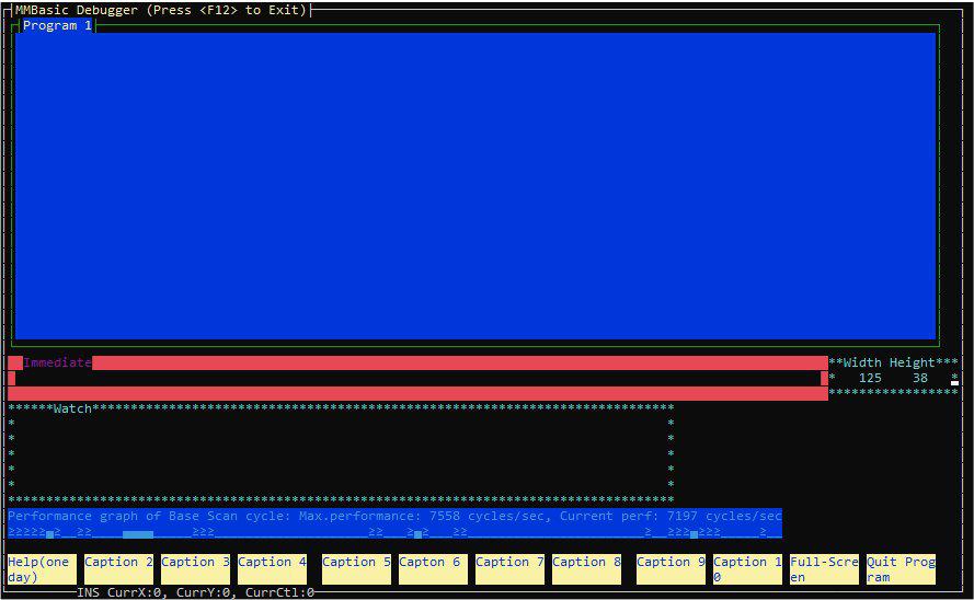

This is after I spent about an hour puzzling things out and trying to make my own windows:
(Warning--there is no code to do what the window headings imply can be done.)
