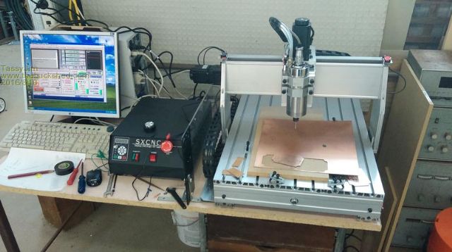

I am thinking about buying a CNC for general work and making PCBs.
The shortlist is a 3040 or 6040 cheap Chinese machine.
The shortlist might get shorter depending on the success of an auction next week.
I have DEX to create gerbers.
I assume FlatCAM for converting into G-code
or DEX has a CNC output which hopefully does the job.
and Mach3 to drive the CNC.
I have an old XP box with a parallel port so that side is covered.

Making progress with the selection.
I had a really good day at the auction yesterday so the budget has increased.
http://www.examiner.com.au/story/3970724/rare-porsche-auctioned-for-huge-price/?cs=5312
I usually only want a single board and tend to stick to through hole components so the small size restrictions shouldn't be an issue.
I will probably go with a 6040 with the 4th axis for wood turning.
There is now a version with USB instead of parallel port so that makes finding a PC to drive it with easier.
The 6040 has a good spindle speed and plenty of power. (OK that's if you believe the specs)
If I don't find any Australian stock, I have a 4-5 week wait.

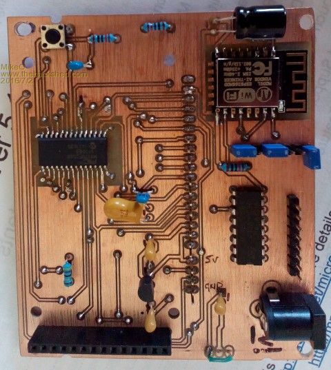

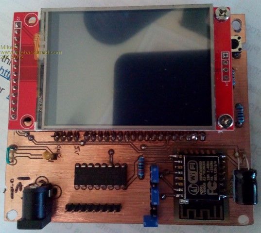

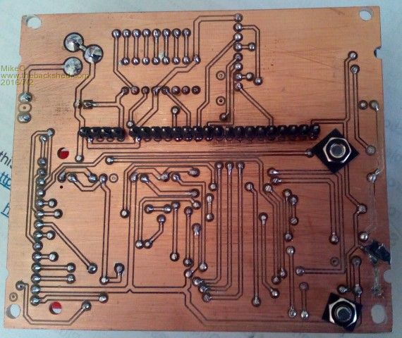

Jim, I missed your post on this as I have a CNC machine and regularly cut boards by isolation milling.
I have a Carving unit basically a 6040 unit with 800 VFD water cooled motor. It seems now that carving have changed their name. I went for this model as it had more substantial drive rails at 20mm.
I purchased a parallel drive unit only because I intended to rebuild it to my own specs and drive card which is USB from a company called Planet-CNC. I have had very good results with the software and can recommend it. I use an XP box.
It has taken me some time to learn some techniques but i am now very happy with the results I am getting.
Cheers Mike

I ordered the 6040 with parallel port and TOLL transport have it in their hands. Should arrive next week.
I have the XP box ready and just need to do some work on the table it will sit on.

I think you may be quite CAD experienced but I use CamBam for drawing up my milling operations, bezels and enclosures like my latest project , I also did the plastic fabrications for the motor and bearings mounts on the mill.
Here is a couple of shots of isolation milling , you will note I haven't made the move to SMDs yet!
Cheers Mike

I will stick to using commercial carrier boards to get the small surface-mount ICs up to through-hole size, just like I do now for veroboard.
What spindle speed and travel rates do you use for doing the boards?
I have some 30 degree 0.2mm engraving cutters which seem to be right for the job.
MikeO
Joined: 11/09/2011
Posts: 275
Posted: 05:45pm 01 Jul 2016
@Jim, Yes those 30' 0.2mm V bits will be good, I use those. I traverse at around 1000mm/min and spindle speed 12000rpm. I am getting better than 0.075 - 0.1mm cutting depths now , Planet software has a feature called Warp that allows you to map out a grid on your copper (by touch sensing) of surface depths which can then be applied to your gerber when you import it. Its cool to watch it dynamically adjusting the cutting depth as it mills the board.
Mike

I think I was lucky with the machine I ended up with. None of the drama that I have since read about.
I have yet to cut a board but I am getting close.
I use DEX for the PCB design and the CNC files it produces look like they will do the job.
This will save one step in the process.
I am starting with single sided boards and I wrote a program to flip the DEX drill files so I can do that step from the bottom without the need to turn the board over. One less step where disaster can prevail.
I like CamBam for quick bezels etc and for now I am still on the trial version. I leave it running all the time so it will take a while for the 40 starts in demo mode to finish. By then I will know if it is worthwhile purchasing.
Trying to learn DEX, CamBam and Mach3 all at the same time is interesting.
I have limit switches fitted to the mill now so that makes me a bit happier.
I also have a heater in the shed now so that makes me a lot happier

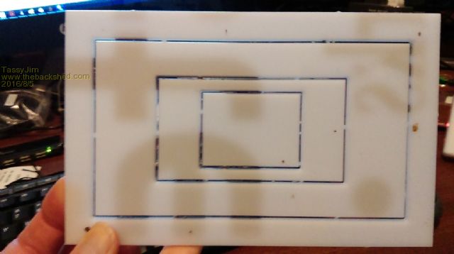

This is a nest of bezels for 7", 4.3" and 2.4" produced on a bit of scrap acrylic sheet.

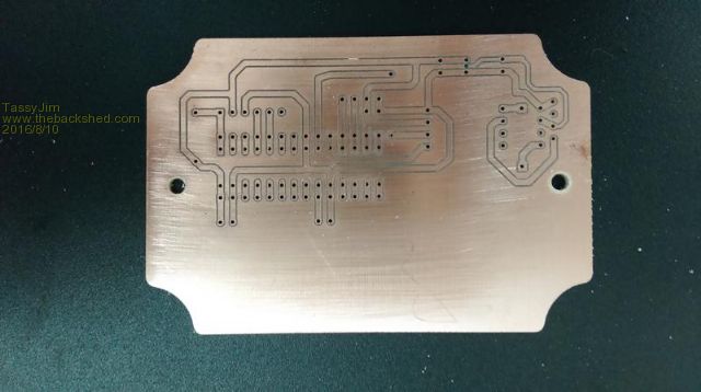

My first (I don't count the first first attempt) PCB
Still a lot to learn.
I used DEX to do the layout. I am having a problem with DEX but I am confident that Iliya will have a solution soon. (A strange bug and I am glad that it's not me that has to fix it)
I wrote a program to flip the drill file so that I can do all the engraving and drilling from the bottom side without having to re-position the board.
AutoLeveller was used to probe the board and compensate for the lack of flatness.
TurboCad followed by CamBam did the board extremities.
There are a couple of areas on the board that needed manual cleanup but, for a first, I am happy.
